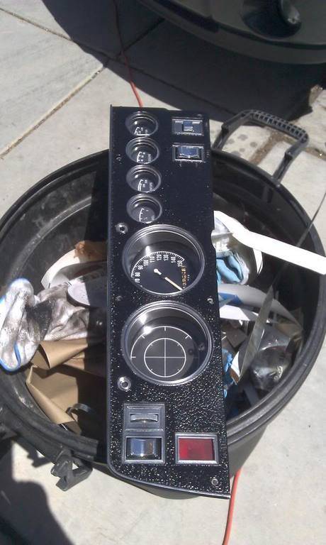

Wow - you don't sit around twirling your thumbs. Nice work. Did you use chrome paint or foil on the dash pieces?
Actually its a 2 stage paint for the Chrome, its only used with an airbrush. It comes out the closest to Chrome I've seen. It has a mirror reflection when sprayed on a flat surface like Chrome and not like silver paint. It's only $9 for a small bottle. It's called alclad, you have to paint what ever u want chrome, gloss black first then mist over it with alclad. I used it on another dash bezels and no one knew it was $9 paint lol.

finished the dash bezels with new face plates, paint and chrome. also re-glassed the go-wing

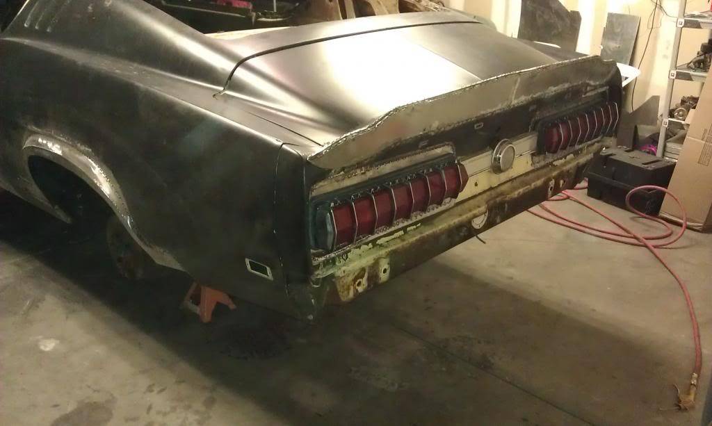

heres another one of my projects...I know its not a mopar but it will be a cool lookin custom talledega/Shelby lookin torino kinda thing lol
flared fenders, welded in a modified set of cougar taillights to look like Shelby's and made a mooby talledega spoiler along with a talledega front end.

it was $30 for all new face plate stickers including the tic toc tach stickers and other option gauge stickers.
