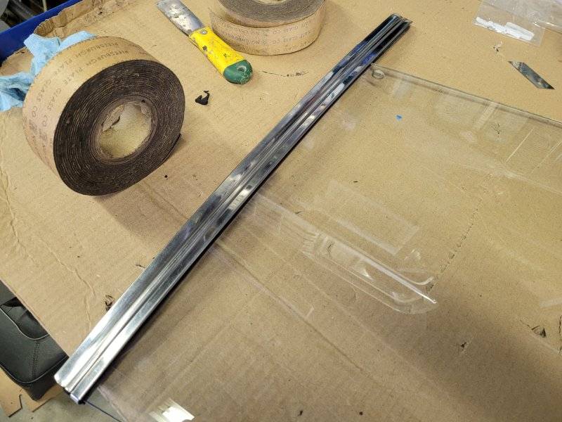

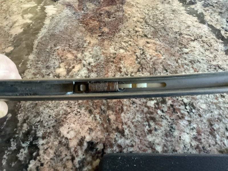

What holds the chrome/stainless piece on the trailing edge of the door glass? Also what does the plastic piece with the spring do?
Spring and wedge is an anti rattle mechanism.

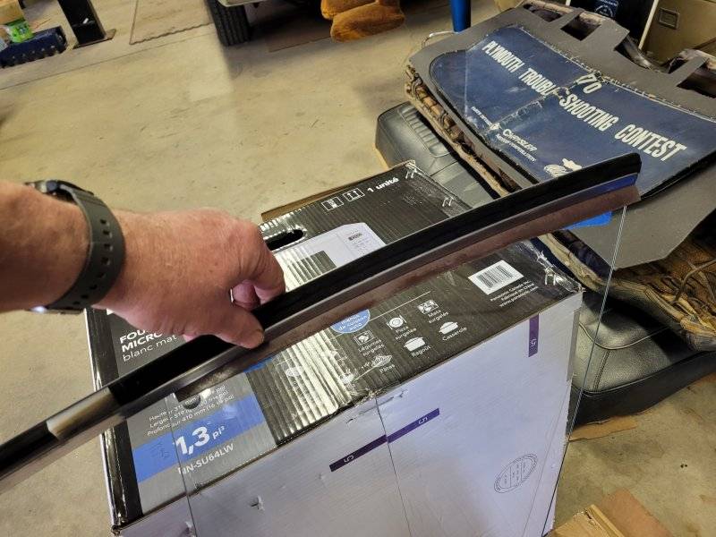

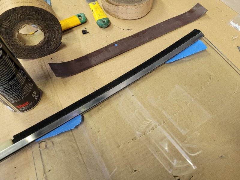

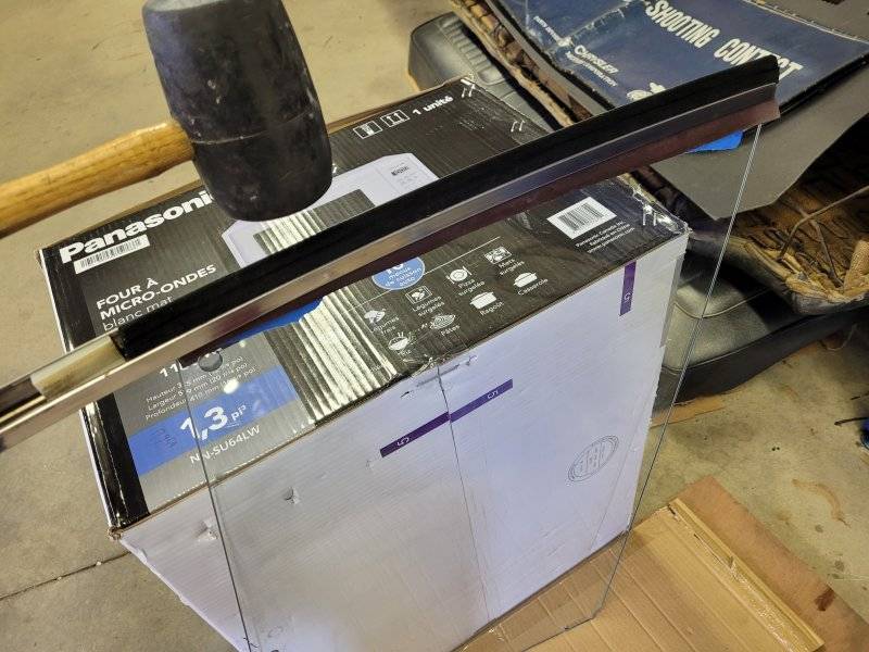

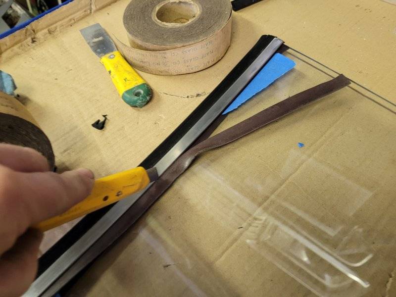

I would think after 8 years of being here you'd have seen how the trim goes on by now... but here ya go!

It's not felt. It's a type of heavy butyl tape. Look for the video link on DMT's site with the tape on basically how this stuff works.
Thanks again for your reply. I have glass setting tape. Rolls of it in different thicknesses. I’ve used it hundreds of times on other glass in the channels.
