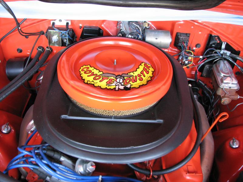

having a big problem with heat soak/vaporlock on my 70rr that has just been put back on the rd.i have been trying to fix this for 3 months.its a 383 with a little above stock cam.edelbrock 1406 carb.factory hp manifolds,air grabber hood. starts and runs great .no engine overheat problems.has a 160 stat in it.3 row radiator.but after you drive it until it reaches operating temp and cut the engine it will not start un til the engine cools down some.i put a .500 phenolic spacer on it andit helped a little.im wondering if the edelbrock carb might be the problem.i have heard that is a common problem with them ,or could it be the timing ,its set about 10btc.im thinkink about putting intake gaskets that block the heat crossover. any and all suggestions would be appreciated. IMG_2065.jpg
