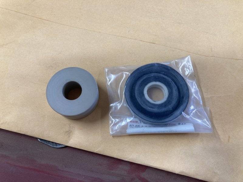

Different year of course but this is what I had made for my 65. Originally it uses this rubber/plastic boot on the end of the column for shaft alignment and to keep the junk out but I had a guy make me a Delrin bushing to go inside the tube. When I work on the column in the future, I'll be using both units.
1965 AND 1966 are very very different animals compared to later years
