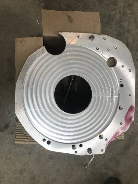

why , because i got the wilco kit , for next to nothing and had a spare tranny
so in it goes . how does the 518 bolt on to a slant six ??
Chrysler made the adapter plate for 727 to slant for their trucks in the 60's. It is a bellhousing plate with a spacer for the torque converter. Will work for the 518.

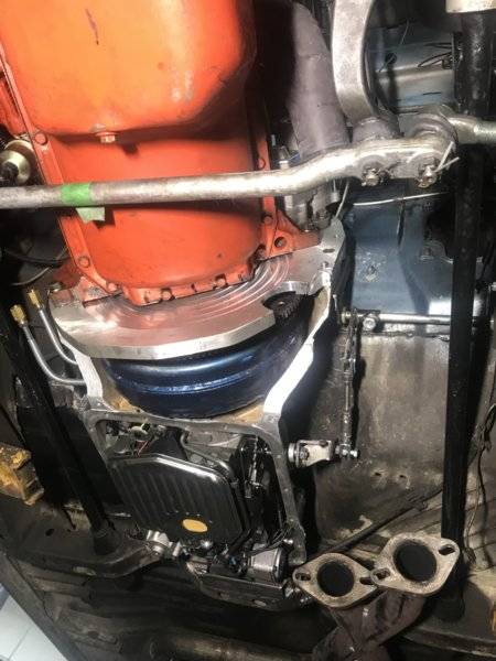

i have a lock up just there are a couple of ways to make it work , the one from tic seem best
for the price. going shopping at summit again!

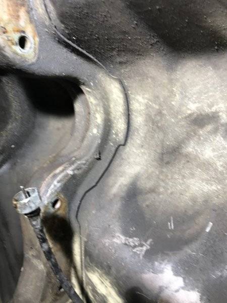

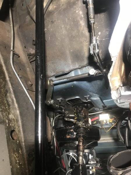

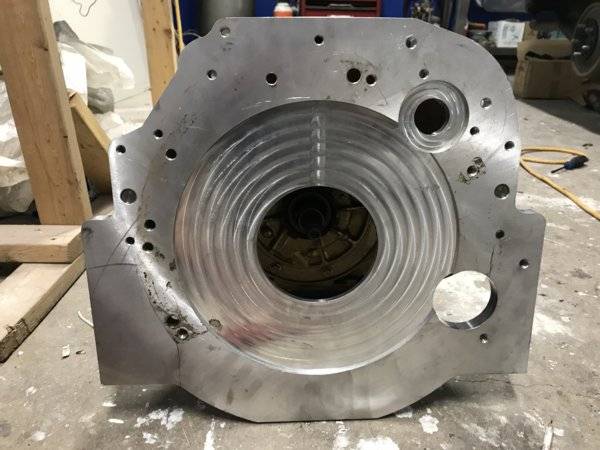

there gonna be some cutting of the floor , lucky there room to reinforce the middle cross member

i just trimmed the back plate today with a recipro saw , it went actually well and buff it month with belt sander

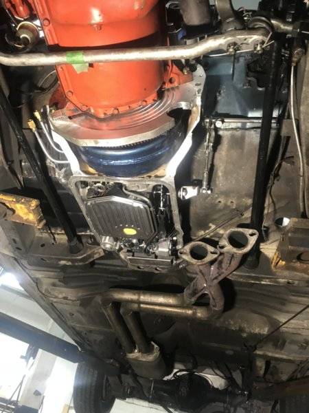

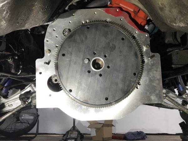

its just been rebuilt , i have 2500 high stall torque from a corvette in it
I ve been at it alle day to try to get the shifter linkage to work and have a smooth feel , the extra gear is tight fit but now I think I got
will take another day to finalize it.
