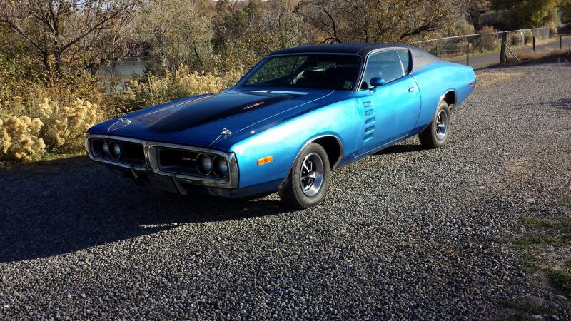

I'd like to jump in here with a similar question/need for help. Purchased a 74 Charger coupe. It's a Frankenstein as it has what I believe to be a 440 magnum 71 engine, and the body looks like it has 72 rallye doors, and the hood looks like a buldge and has a ram charger scoop. My questions are: what year(s) were the rallye shark gill doors offered? What year and models were the buldge hood and ram charger scoop offered, AND was it possible to get all these features in one model: door gills, buldge hood and ram charger scoop? It looks like the ram charger scoop may have been "cut into" the buldge hood -- but everything appears to be there, right down to the switch in the interior. Just trying to figure out what I have.
The Rallye doors were 72 only. Bulge hood was available all 4 years but each year has different cowl vents. Ramcharger hood was 71-2 only. 72 Rallye would be the only year with the doors and Ramcharger hood together.
