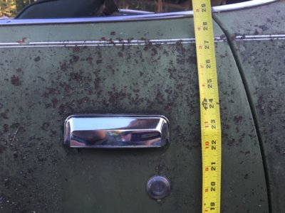

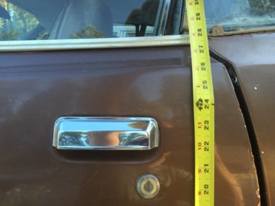

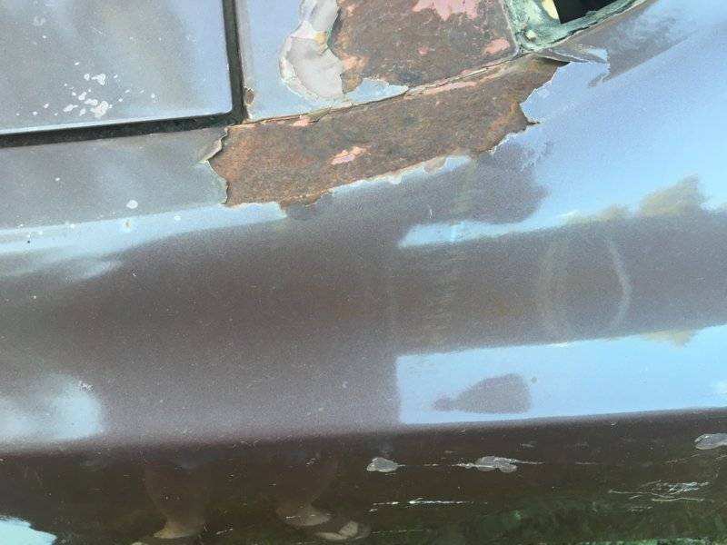

Here is a brown 74 door and a green 72 door. The 72 door is taller and the body lines are convex at the top. The 73-74 doors are cut lower and have a concave at the top.
Not shown is how the lower body line also was raised up in 73.
You cannot put a 71-72 on a 73-74 or vice versa, and expect anything to line up at the rear.
The 73-74 doors have continuous body lines top and bottom, where the 71-72 have the double diamond sort of shape similar to a 67-70 Charger door, with body lines that do not carry through near the "louvers" on a 71 R/T or 72 Rallye.
Also notice the lock cylinder is in a different spot too.
Inner upper door panels also do not fit between 71-72 and 73-74.
Oh yeah, and the 73-74 doors weigh a ton, because they have a huge side collision beam added inside.

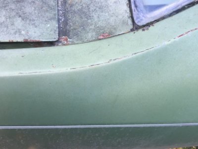

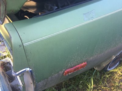

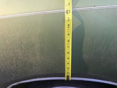

Here is a brown 74 quarter and a green 72 quarter. While the wheel opening stayed at the same height, the body line on the 73-74 was dropped considerably. About an inch.

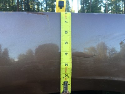

Another shot of a brown 74 quarter and a green 72. Notice the concave shape at the upper quarter. The 72 body line is straight at the rear where it meets the quarter extension piece. On a 73-74, there is an obvious kick up to the body line. The quarter extension piece is much squarer, and has the odd angles.

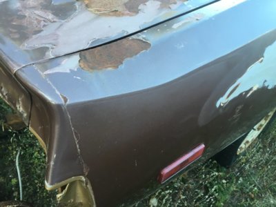

Another shot near the back window showing how he brown 74 quarter has a completely different look than the green 72. The 73 redesign made all the body lines much more pronounced, lowered and exaggerated.

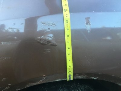

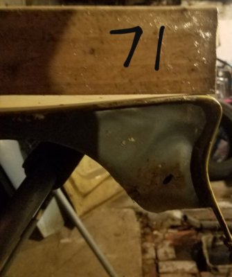

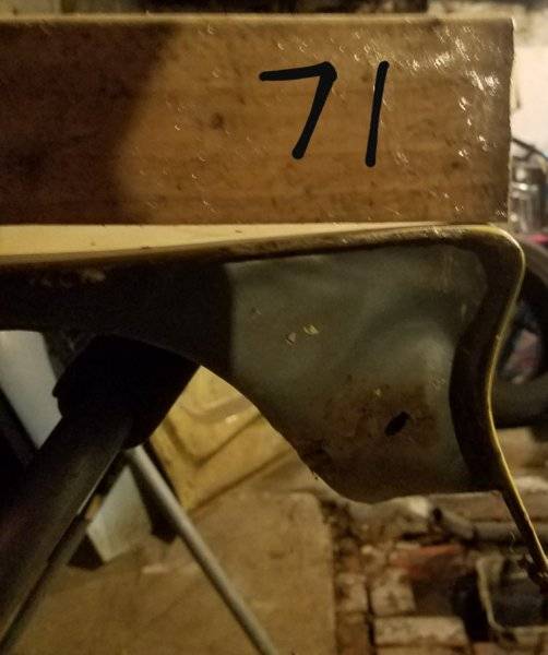

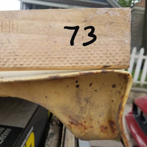

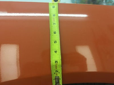

The wheel opening on a brown 74 fender is raised up, compared to the Orange 71 fender.
This is because the suspension was radically changed in 73, lowering the car. The wheel opening was moved upward in 73 about 1 1/2". This is one reason that 73-74 Chargers look like low riders compared to 71-72's. because they are!
