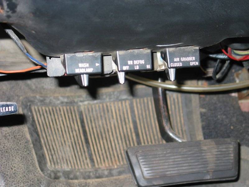

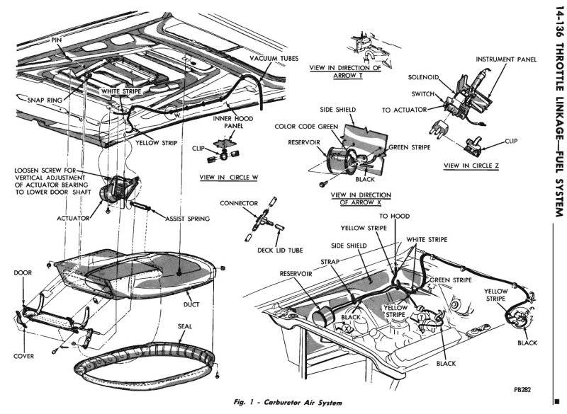

I’m trying to install the correct switch and mount for the n96 ram charger that was used on a 71 or 72 charger. Would you be able to provide a photo please? would help me also ensure I get the right mount spot also. Thanks
I would like to see a photo of the vacuum line routing through the firewall if possible as well.
I can’t help with a ‘71….but on a ‘70….the switch is next to your right knee while driving. There was a factory template on the back of that dash piece that showed exactly where to put the switch. The hoses go through the firewall right above the heater box & there was a dimple switch n the firewall showing exactly where to cut the hole
