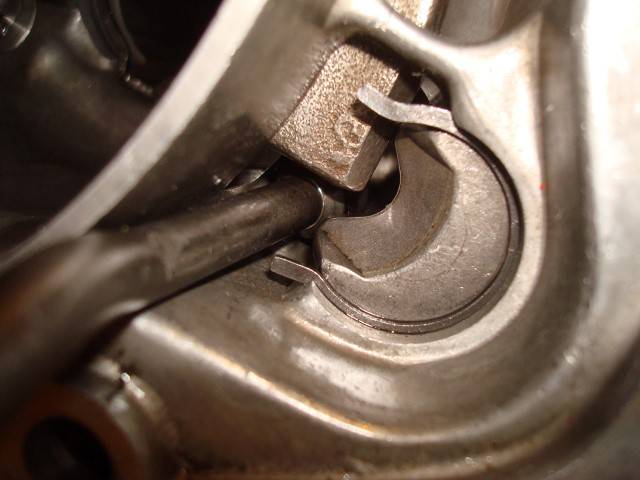

The park rod probably missed its slot and got jammed over the snap ring.View attachment 1150225

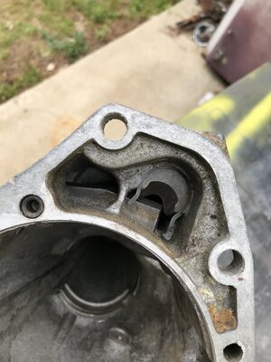

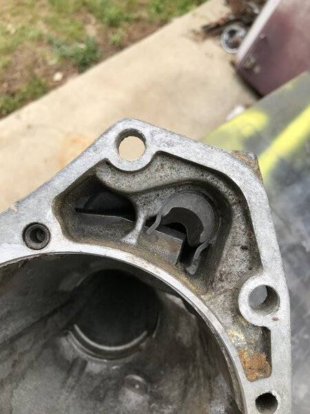

I thought the same thing. So I’ve just finished pulling the extension housing again and making sure everything is lined up correctly. Again all 4 corners on stands she locks up in park no issues. Then I adjusted the linkage to the Haynes manual specs, again everything is working as it should. Drop it on the ground and push in park CLICK CLICK CLICK CLICK CLICK. The dog just bounces out of the gear on the output shaft. Pick everything up, adjust, set it down, no park. Tried disconnecting the linkage and it will not stay in park gear. It did before the driveshaft went in now it just pops out unless the dog and gear are lined up.
There is no good information out there as to what my troubles could be. Short of pulling the the dog that engages the gear and welding onto the tip to extend it I’m out of ideas.
