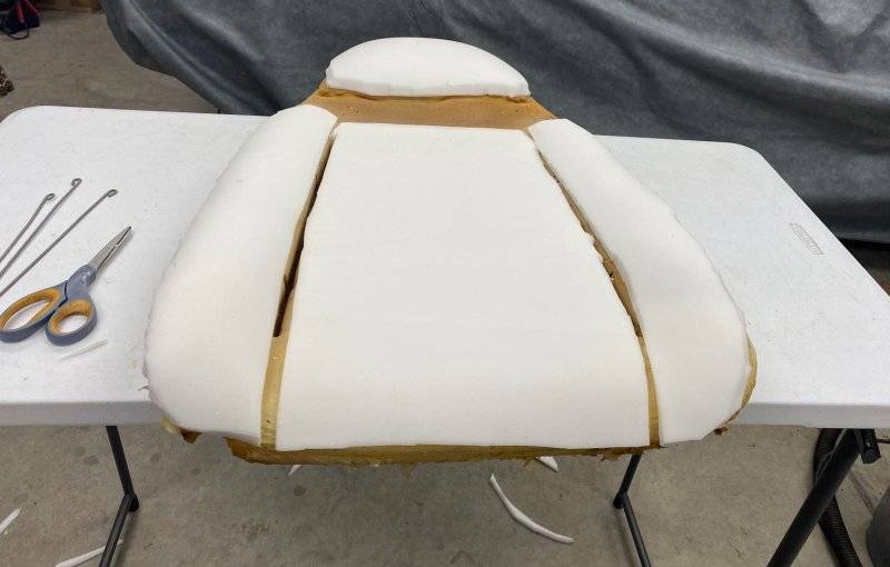

Softer on da arse?
That and the original foam is not what it was when new. It looks good but the covers would fit loosly and look like crap. I see so many cars with new seat covers with wrinkles and I don't want that look. I believe in spending a little more time and effort and getting right even if it's only a lowly 71 Charger.
Note to self: add 1/2" foam to seat bottoms on top of good existing foam. "LOWLY 71"? Wish for a 71 over 72, SMOOTHER SIDES imo. LOOKS GOOD JEFF.

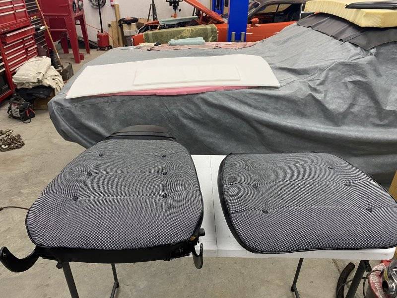

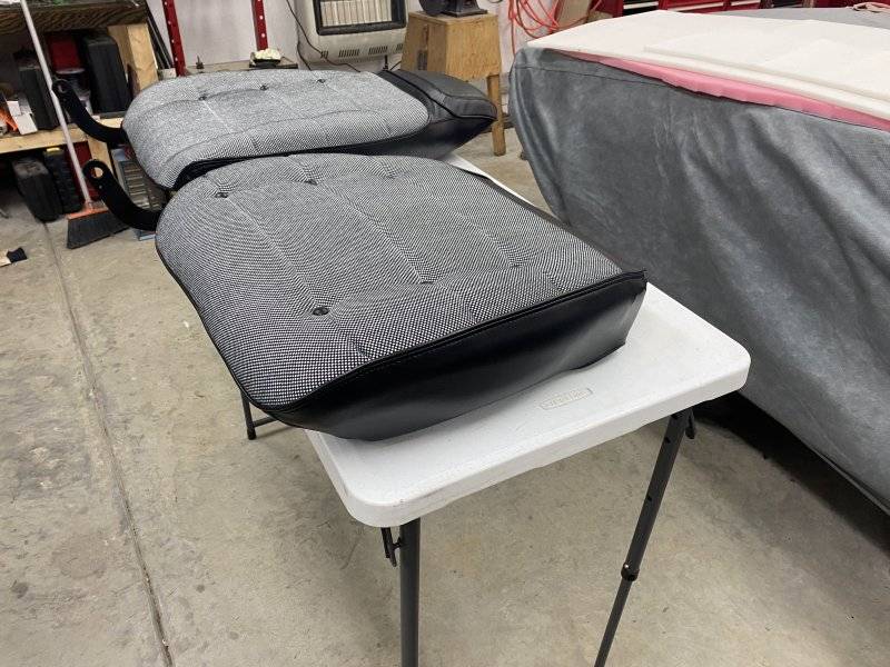

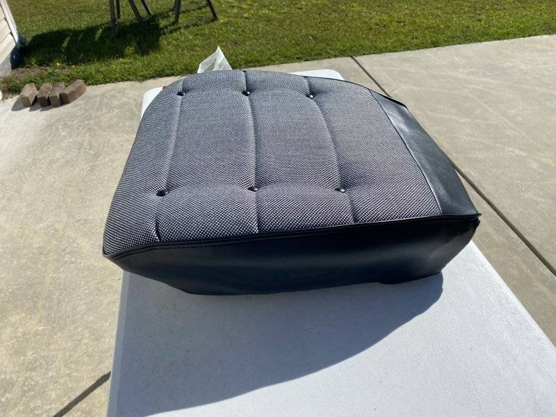

Passenger seat is done. Same process as the other side. Now working on detailing all the small parts to assemble.

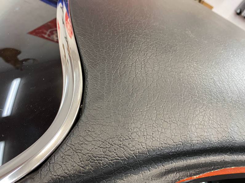

Hit a stone wall. Vinyl top is lifting from being out in the sun. I used the 3M super 90 adhesive but it is not holding. I had to pull the headliner top back at the rear windows to remove the nuts for the top trim. Ordered some DAP top adhesive and will try to re-glue it. Damn I don't want to wait a year for a new top from Legendary... Any thoughts on cleaning things up and laying it back down?
Really hard to see in the pic. Be careful peeling it back up, it can stretch and deform the grain. Good luck, sorry to hear.
If you're other option involves destroying the current vinyl top . . .
Perhaps this would work -
I am pretty sure I can save it, just will be a tedious process.
