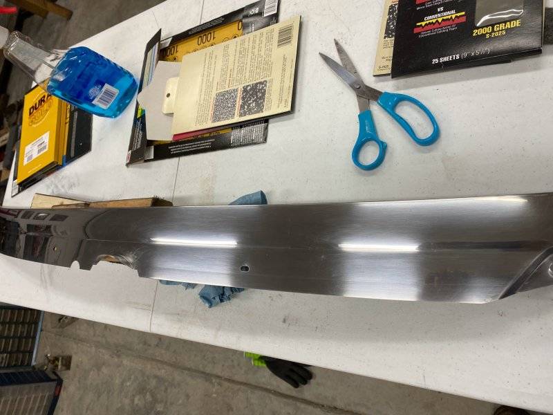

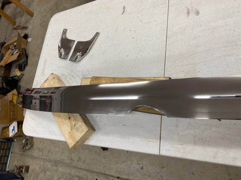

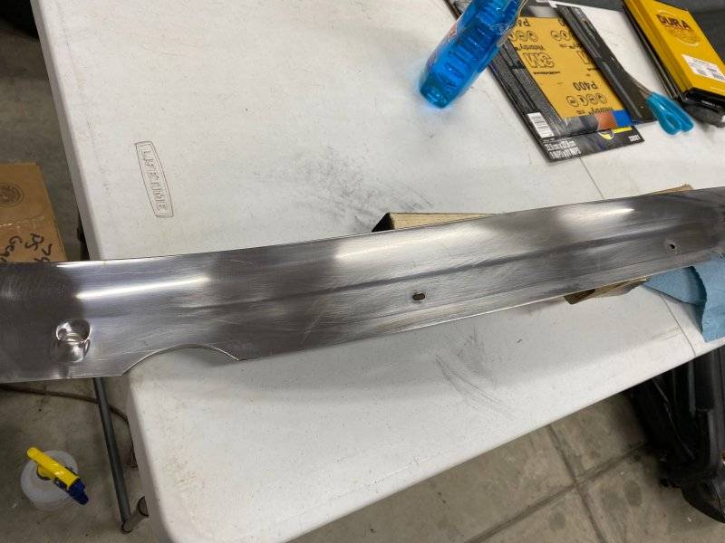

After loading up the 440 for the 74 to send off to the machine shop I started on the lower windshield trim. Had lots of scuffs and scratches. Got it sanded out to 1500 so far. Fingers are raw. Before and after.

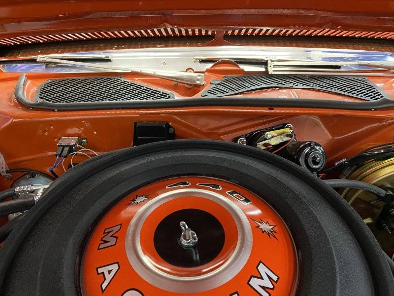

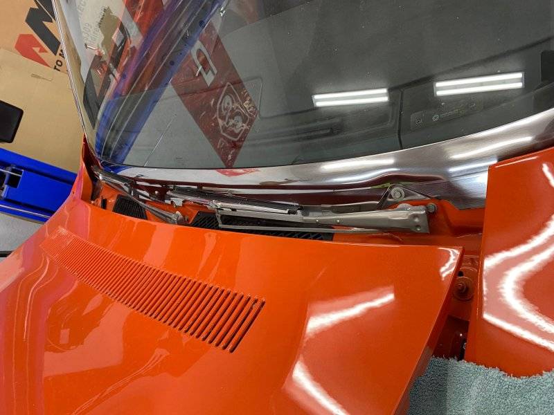

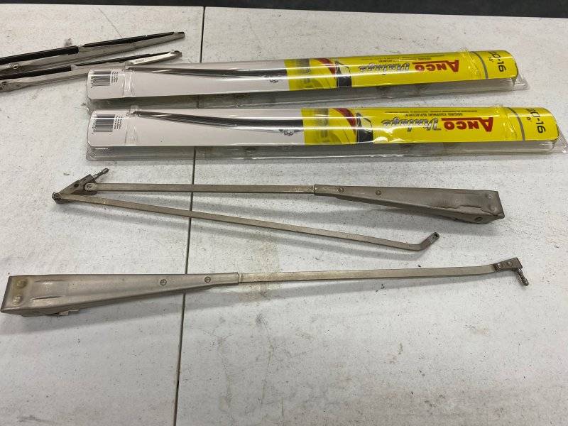

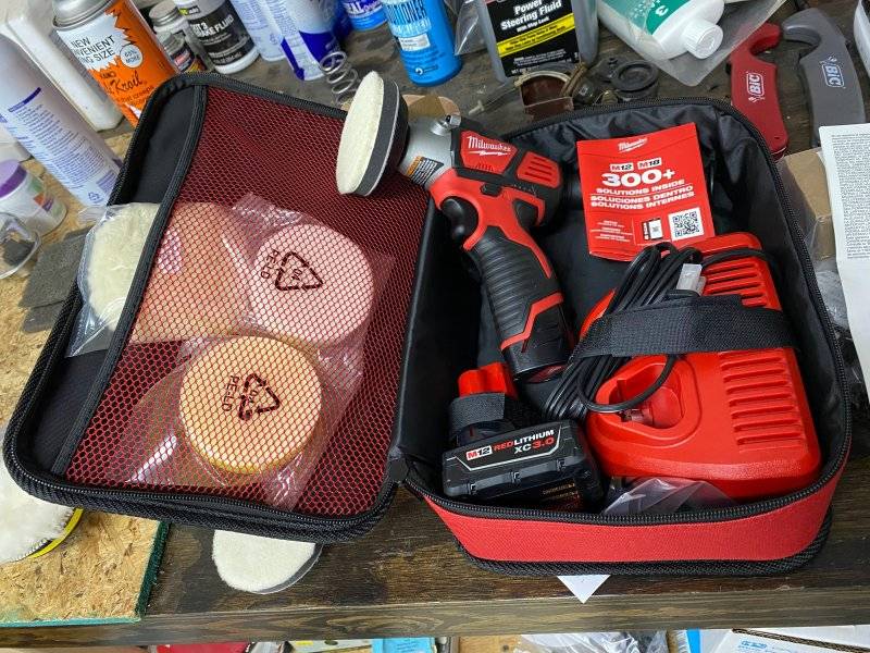

Vacation day today do I was able to finish sanding and polishing the lower trim. My new M12 buffer was perfect for this job. Also cleaned up the wipers with 0000 steel wool and Evaporust and put on new Anco stainless blades. Pretty much the only thing under the hood is the washers.

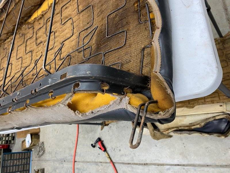

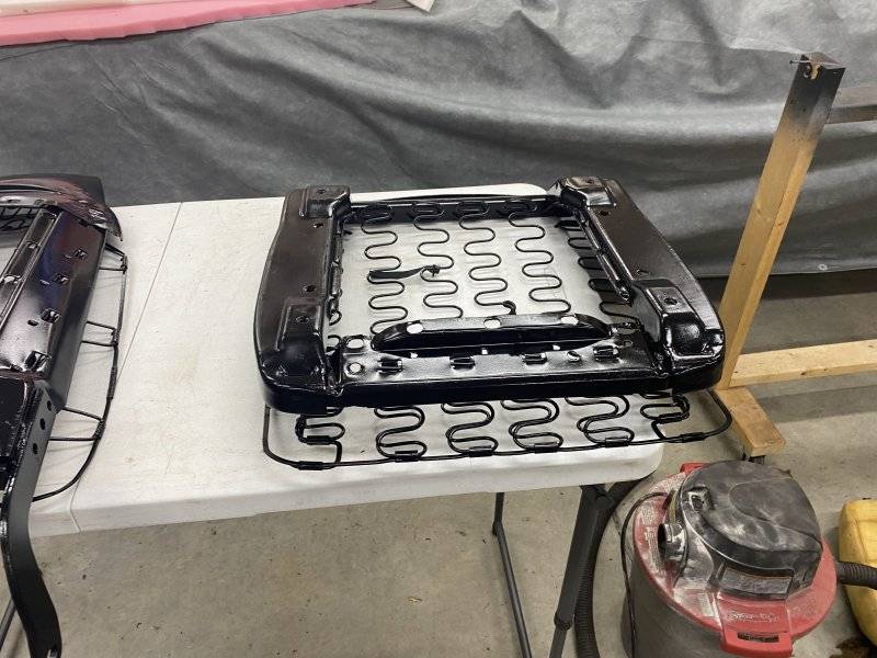

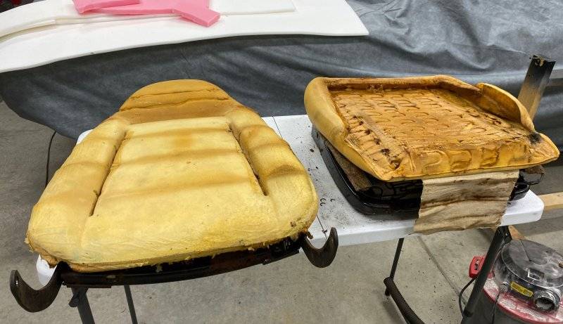

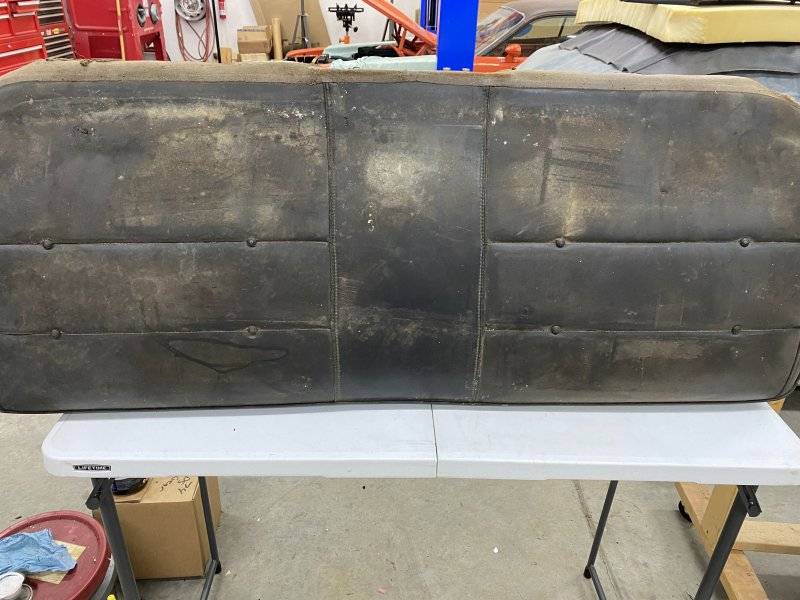

Seat time. Lots of work, tearing them down, cleaning, blasting, and the covers soon. Also drove around...

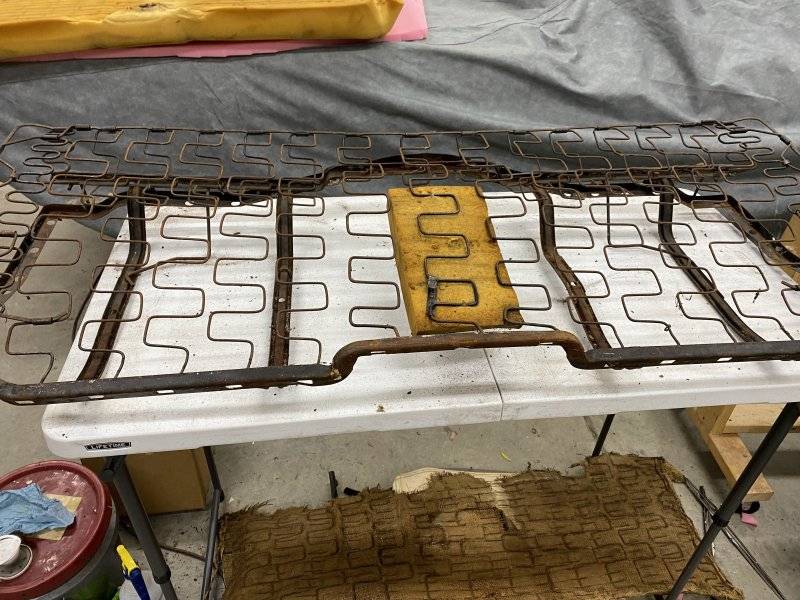

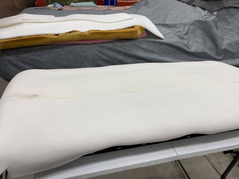

Hmm . . . I didn't have that foam block over the tunnel. I shoved a bunch of extra foam under the seat though for more support. I didn't replace the springs. The front bench is still super comfy with the original foam and springs.

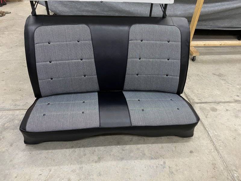

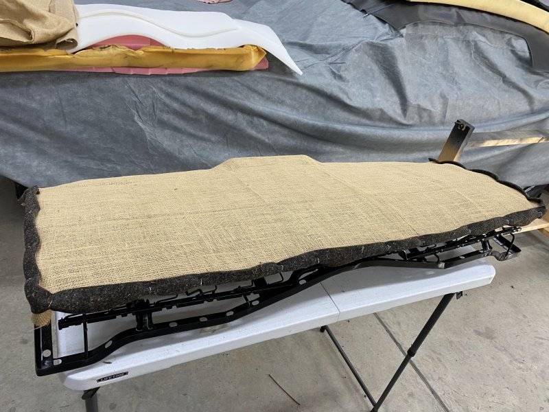

Back seat is done. Almost as big a pain as the side glass. I added 1/2" of high density foam and new burlap on them so tight, tight, tight. Did the final covering out in the sun so they were plenty warm so I could stretch the crap out of them.
The seat covers were much harder to install than I thought they'd be. I didn't even try with my front bench. Luckily it's still comfy after 50 years!

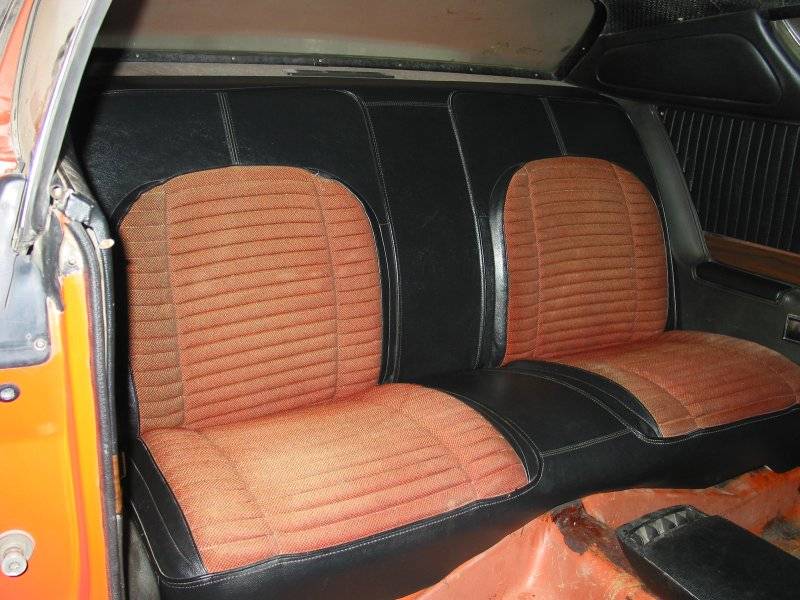

Many years ago when I bought my 71 it came with this were the back seat.
I've since replaced it with the proper 71 hounds tooth cover.
I don't remember if I kept the 73 cover.
I used the same frame and foam for the 71 cover.

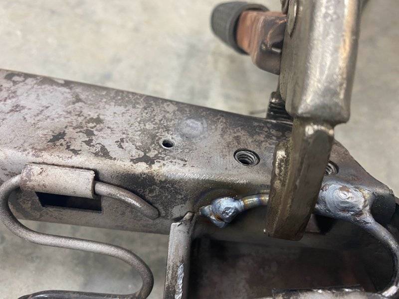

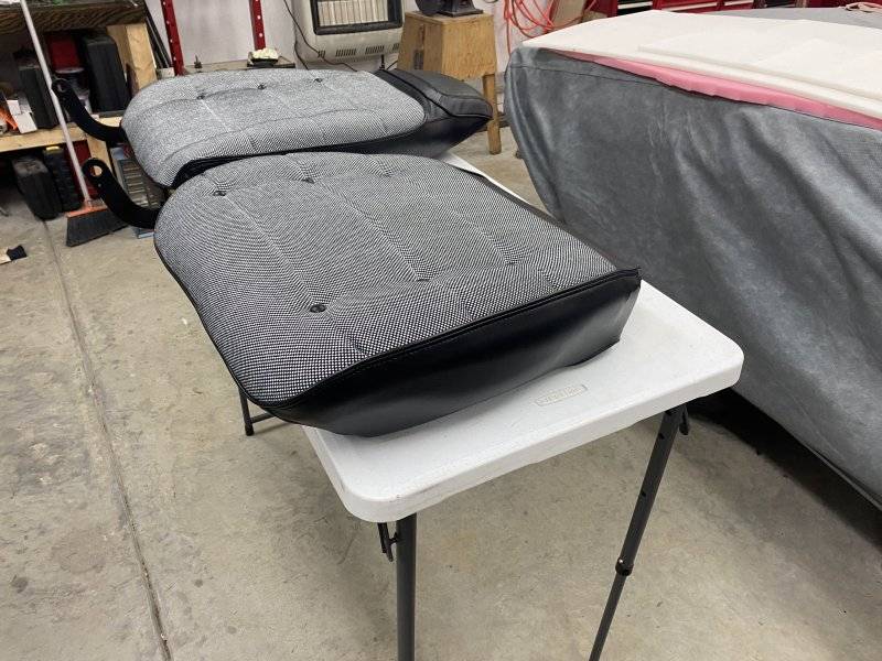

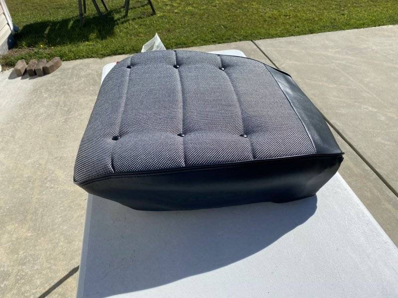

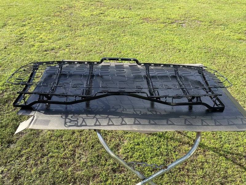

Vacation day! Got the frames blasted and painted along with the reinforcement rods. Had a broken spring mount on the drivers bottom outer spring so I welded it in place. Should have the covers on this one tomorrow.
Drivers seat is done. Adding the 1/2" foam made a big difference on how they came out. A lot harder to get them on but worth it.
