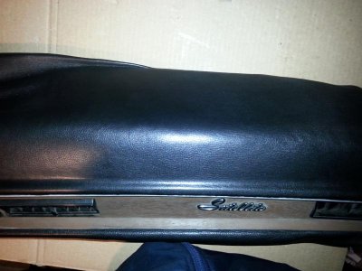

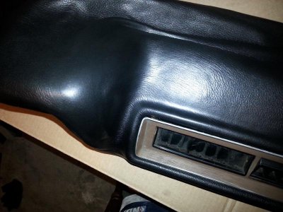

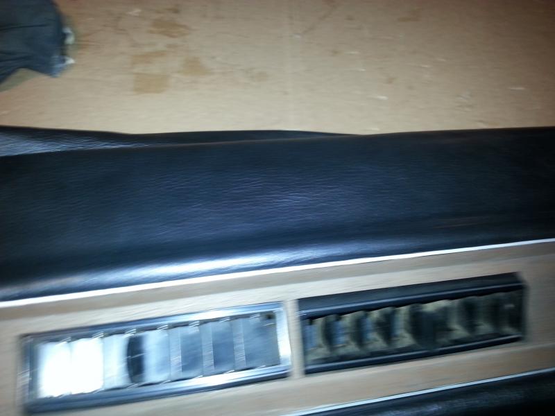

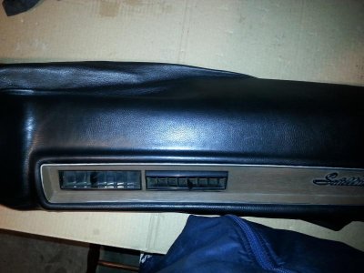

20140521_201625.jpg20140521_201629.jpg20140521_201638.jpgI finally started my leather dash project.I'm taking it a section at a time to allow the glue to set. I'm going to be making some relief cuts tomorrow to finish the top along with a fix on a small crack that is wanting to show a small bulge in the leather. Here's a couple of photos, I think the grain is a good match as well.20140521_201521.jpg

Cool project! Im wondering how youre getting the contour on the area shown to lay right, water / heat? The area between the vent area and the area over the gauges. Yes, what type of adhesive are you using? The grain pattern and your work look great.

The process that I'm using is implementation of working very slowly ! I place the leather especially in the folds of the dash and stretch and work it into place with continued rubbing, it will lay where you want it to.Heat is not necessary for a good stretch you use water on leather but I've found I haven't needed to do so yet. The glue I'm using is 3M super strenght 90. If you use it correctly it works fantastic. So the process is simply work and stretch the leather in small sections, glue that secton and rub it in and make sure there is no lifting, then walk away and come back tomorrow and work some more.At this point now that you have glued the valley of the dash you can now stretch it tight without it pulling out and start going toward the top next. It's just a matter of working slowly and letting the glue set over night but the most important thing if you want good results is to take your time and don't rush.Relief cuts are necessary to get rid of some of the wrinkles, work these wrinkles to corners and up to the dash speaker areas and cut there it works great, another good cut area is where the dash light mounts in under the dash .Just work it slow, when I get it done I'll post the finished job.
