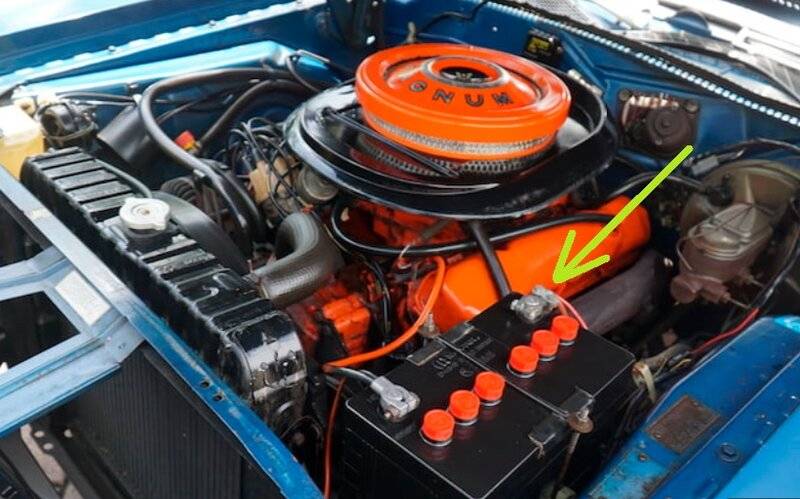

I see two fender tags
Can’t read them though
Yep when I put the engine pic on FULL I saw them... The regular size photos could not see them at all...

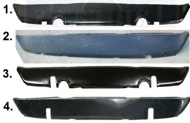

Here's a breakdown on 1971-74 Charger rear valances.
1. 71-72 with exhaust tip cutouts
2. 71-72 w/o exhaust tip cutouts
3. 73-74 with exhaust tip cutouts
4. 73-74 w/o exhaust tip cutouts
