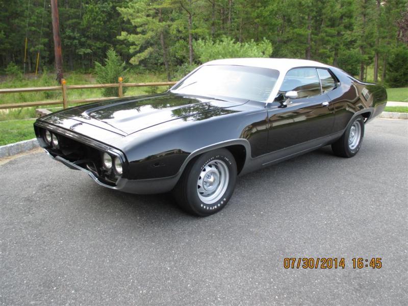

72sat94 (Large).jpgMy 72 is Black and it had Black paint under the vinyl top.

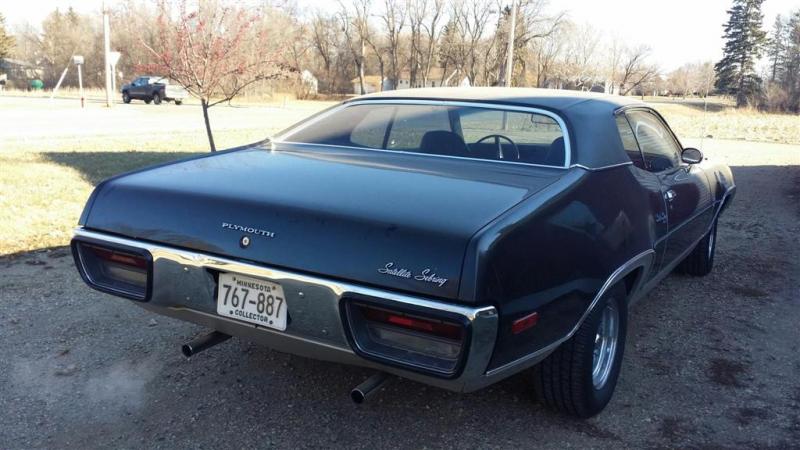

IMG_0275 (Large).jpgView attachment 20572172sat44 (Large).jpgWhat car exactly do you have?

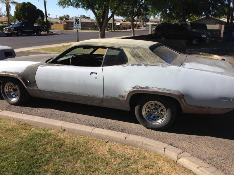

I think from factory, vinyl top cars were never totally painted, just what got oversprayed all around. They were installed over primer saving bucks on paint. That's whay you'll easily find all rusted roof skins
Just took the factory top off my Charger and it was primer. It was modified for a sunroof at the factory but underneath that primer was primer. Factory vinyl top. The telling point may be how your mouldings are attached. Years ago we had stud rivets for the clips but they still look like a rivet with a stem hole in the center. The factory studs for your mouldings wouldn't have that. Usually car dealers didn't use the factory mouldings to add a top because they added to the price on their end. Just some ideas.

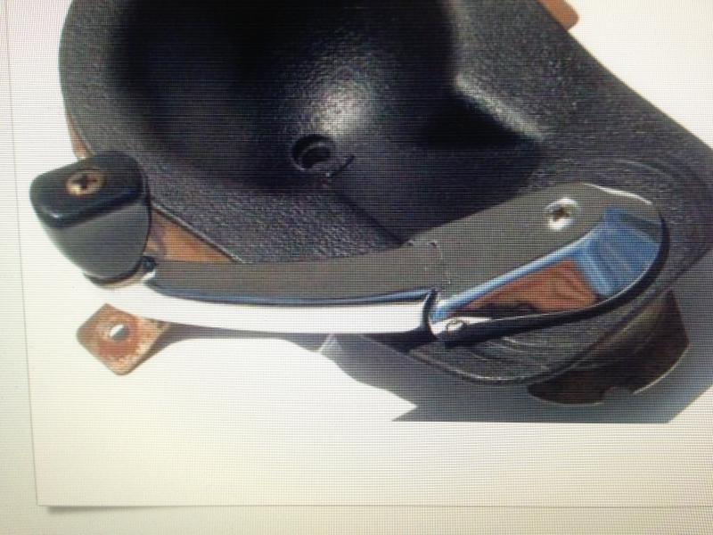

The handle looked like this one. I found this picture of a part that was advertised as a GM part. I don't remember the handle being flat on two sides, but it may have been. Hope this helps.
You turned the crank handle to open or close the sun roof. You could stop it in any position in between fully open or fully shut.
