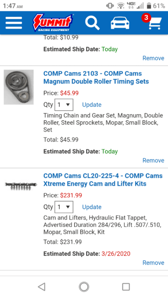

I'm also attaching the cam I'm thinking would work .

that's a much bigger cam

why use chevy cams in your mopar
if you do have 9:1 the 274 hl migt work better even if you do not need as much lift as any of these cams give
you geet more lift quicker trapping more compression
you might want to use the ,028 mr gasket
