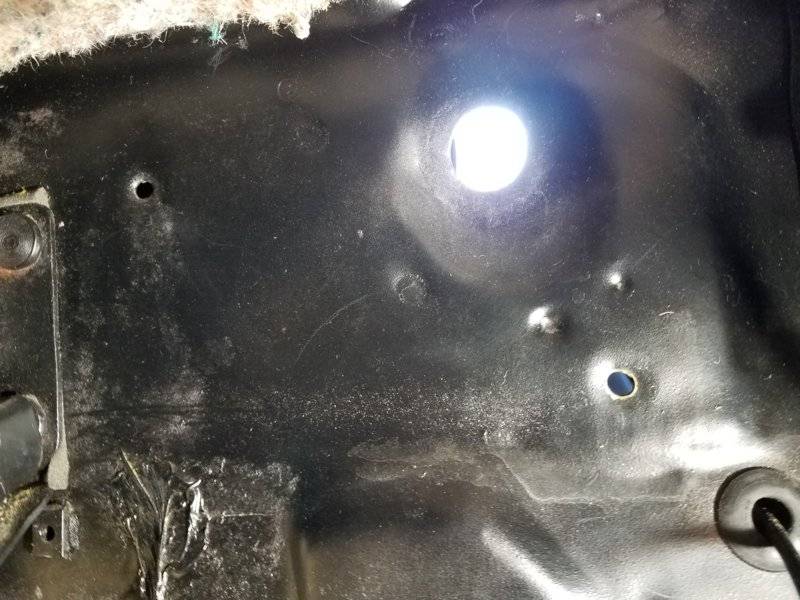

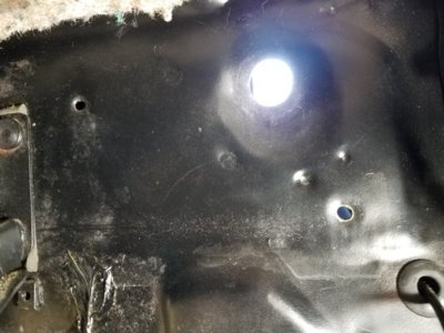

Looks to me like you have an insolation pin in the hole, note the original insolation pad pictured has that corner removed and no pin. Also, the original water valve cable didn’t use a grommet, it had more of a seal that fit a smaller hole, it came on the cable, I’ll see if I can find a picture.
Sir, you are a gentleman and a scholar.
I pulled off the insulation and revealed that "I was in the wrong hole". the insulation pin that is!
you can see in the picture that hole is larger than a insulation pin.

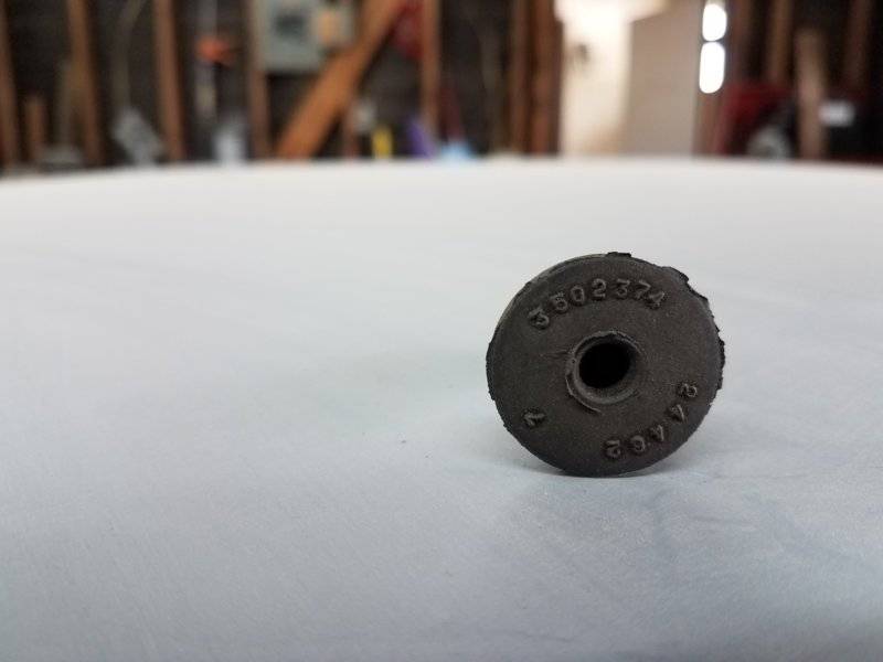

Also found a grommet that appears to fit that hole.
Thanks for the help.

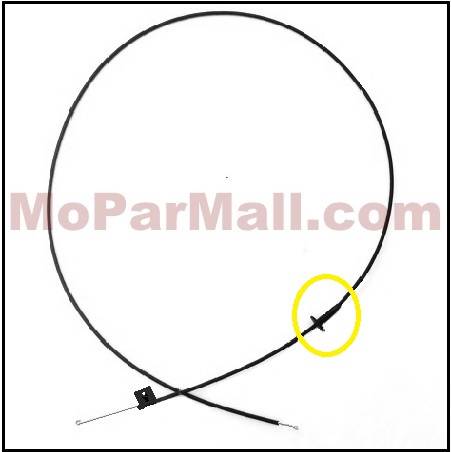

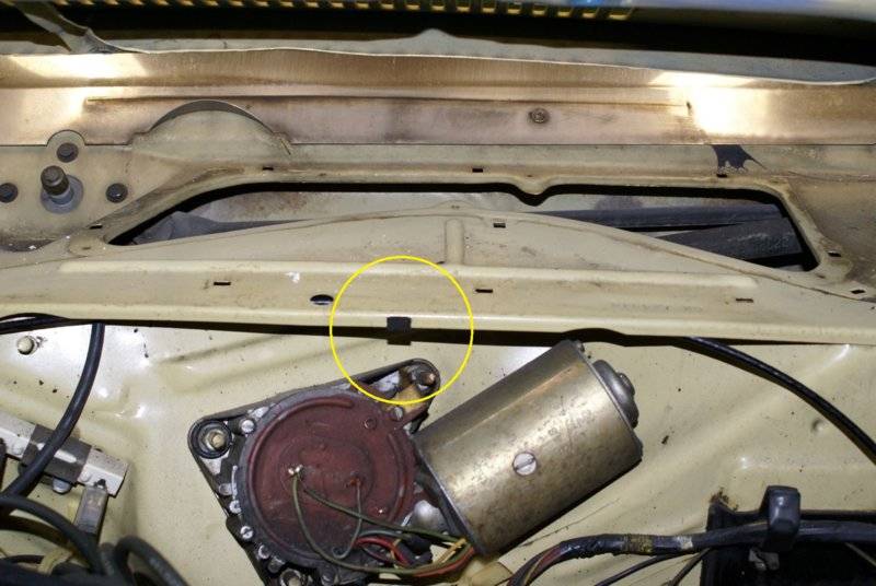

That does appear to be the correct cable seal, originally only serviced with a replacement cable. The original cables I’ve seen appeared to have the seal glued in place on the cable. There was a unique clip that secured the cable on the engine compartment side, mid-cowl, that is commonly missing.

edit-I may have that clip.
