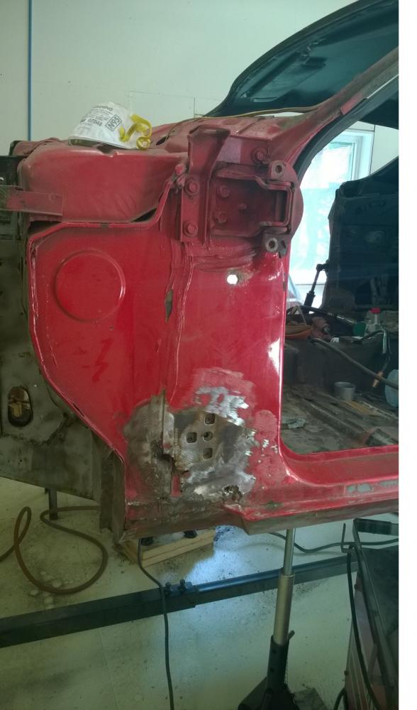

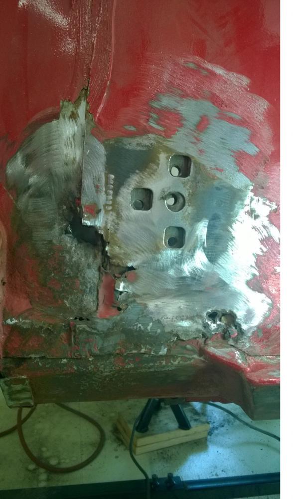

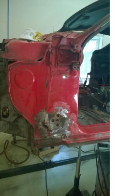

Working on my lifetime project. Ready to tackle the body rot by the lower door hinges and rocker. Can anyone tell me if there is a patch available as I am assuming this is a common problem. Does anyone know if the replacement rocker panels go all the way to the front as mine are also a little soft.
Thanks for the help
Any thoughts on how to do the repair or how someone has made a similar repair would be appreciated.
Thanks
No one make the jams for 71/4B. I carry nice originals. You could patch the damaged areas or change out the whole jam.
Moparmark is a good guy to deal with ! Trust him when he say Good !
I'll second using OEM, but have you checked the AMD E body hinge plate part?
Thanks for the help. I tried but could not find the replacement in b body or e body. Will try contacting MoparMark.
Any other suggestions would still be appreciated.
Thanks

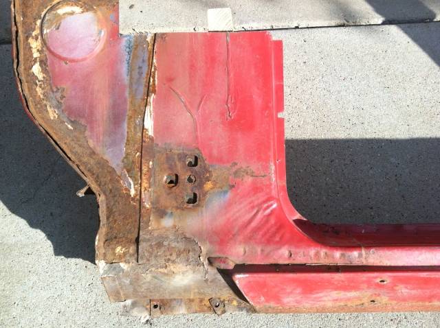

Yeah, they get kinda rusty in that area. Yours doesn't look too bad - I would just do a decent patch job and use some lead or filler to pretty it up. It's not a very visible area when the door is back on. If you want to go the patch route and moparmark doesn't come through, I have a patch that is a little rusty but solid for that area. Good luck! Scott.
