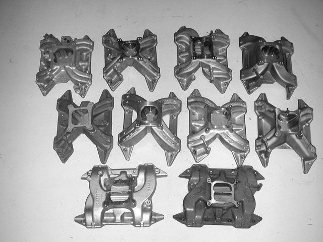

Is there anyone running a performer RPM/holley with the stock hood?
What intakes will fit under the stock hood with a RB?
My bud has a RPM on his 72 R.R Air grabber, he had to cut the fiberglass pan to make it fit.
I'm trying to remember???? I think it's the M1 that will fit??? Anyone know?
The CH4B with stock heads beat out the RPM in bottom end power and only sits .4 higher than the stock intake :)
Some 440 intakes to look over!

This is a great article!
But it does not list a height of each one.....anyone have that info?

I do have the info you need...I looked it up for my bud when he did his,I just need to find it again...I will try and get it for you...No promises tho ,I'm so disorganized I lost my virginity 8 times ;)
STOCK INTAKE HEIGHT-------- 3.05 , 3.49
HOLLEY-
crysler dominator HR/SP Holley-300-14-
Power band: 1500-6500 RPM
Height: Front 4.13", Rear 5.25"
Port Size: 2.14” height 1.12" width
-WEIAND-
action + 440 -8009
Power band: Idle-6000 RPM
Height: Front 3.25", Rear 3.69"
Port Size: 2.18” height 1.14" width
team G 440-7534
Power band: 3000-7800 RPM
Height: Front 4.38", Rear 5.31"
-EDELBROCK-
440 PERFORMER -2191
Manifold height: A-3.80", B-4.80", measured to engine block, see A/B Measurements. Port exit dimensions: 1.12" x 2.14".
440 RPM-7193
Manifold height: A-4.90", B-5.80" see A/B Measurements. Port exit dimensions: 1.13" x 2.09". Manifold measure 8.75" across block.
440 TORQUER II-5091
Manifold height: A-4.15", B-5.20", measured to engine block, see A/B Measurements. Port exit dimensions: 1.10" x 2.17"
