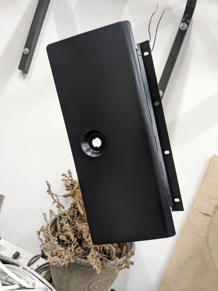

Every time I look at something I haven't touched, I realize that it needs work. So I went to put my glove box back in today and instead decided to repaint it.
It's the little things that are going to keep dragging this out.
View attachment 1631012It's the little things that are going to keep dragging this out.

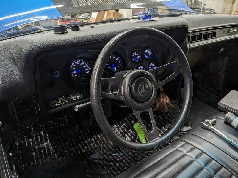

I got the dash installed tonight. One of my vacuum tubes broke off the heater control box. I'd already spent too many hours folded up under the dash so I shoved the tube into the plug and hoped for the best. I'm not in the right mindset to fix it properly right now considering how much work it would take. Also lost my steering wheel nut. Found another that's a bit too tall, but it'll work for now. The horn is still functional.

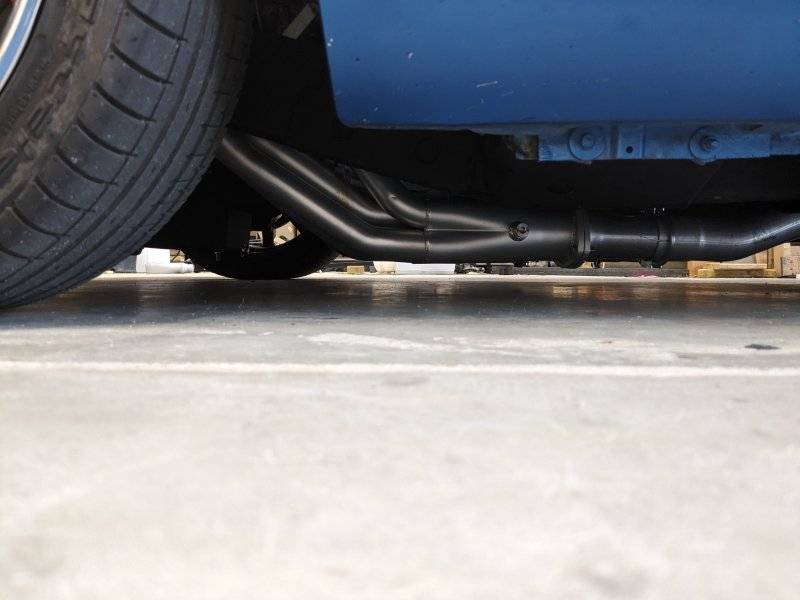

I also found out that the TTI headers are very low. I only have 1.9" of clearance at the lowest point. As good as it looks, I'm probably going to have to raise the front a bit before getting an alignment.

FYI for those that like the lowered look (like I do), the TTI headers are very low with my setup. I measured about 1.9" of clearance.
As much as I like it, I think I'm going to have to go up a little in the front.
