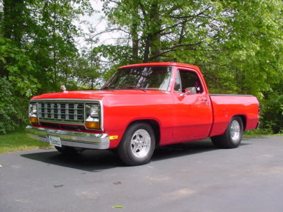

I posted this on another Mopar website: Suddenly the 727 in my pickup is not shifting into high gear. First to second is normal around 15mph unless I accelerate hard. Normal acceleration or otherwise it doesn't shift into high gear at all. It stays in second. I haven't changed anything recently. The kick-down linkage is attached and adjusted to be all the way back when the throttle is at wide open, which is where it has always been. Any clues? Thanks!!

I'm going to try unhooking the kickdown rod and see what happens. It sounds like the trans is going to need to come out. I'm not looking forward to that, I'm old. The motor and trans in the truck are a 440/727 from a '72 Chrysler. Both were rebuilt when they were installed thirty years ago.
