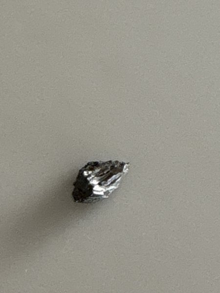

I think I found out why there was no bolt on the bottom dipstick tube tab. I found this when I was removing the dipstick tube for the 3rd time. I felt around and could feel any chips around the hole for the bolt. I used a 5/16 ¾” bolt, but it seemed from the get go that it would never tighten. I guess it’s stripped before I bought the car. Question is, O bought an aftermarket dipstick tube, it has a grommet to seal instead of an airing. Will the hole where bolt belongs leak? It’s full of fluid, but I’m hoping it’s from the tube leaking. . BTW, I don’t know if you can see it, but that chip has threads on, so it from that hole for the tab.
I don’t believe that hole goes all the way thru. I’m assuming the tube has an upper bell housing bracket. That’s all that needed.
