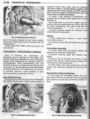

What is the proper way to take the endplay measurement? I keep seeing conflicting things about letting the case support itself and pulling up on the output shaft and then some say to lay it on its side and pull on the output shaft.
I will say that I cannot seem to get any reading out of when it is vertical case supported. When it is on its side it is .15". That seems tight from what I have read but I am not sure I am even taking the reading correctly if it should be vertical.
Thoughts?

this is from a 1973 FSM
Vertical or horizontal either works... Vertical is nice cause gravity makes sure all the movement of the planetaries is forced to the rear... But now in order to measure the end play you have to overcome gravity acting on the clutch packs... As mentioned above pliers help....
In the horizontal position you don't have to fight gravity but now getting a reading cane effected by the planetaries not being fully rearward...
Like Mike mentioned you develop a feel for it...

In that picture is it actually sitting on the tail shaft or should the case be supporting it?

Ok, definitely needed to use pliers when vertical. Sitting on the tailshaft and using pliers I am getting .042".
