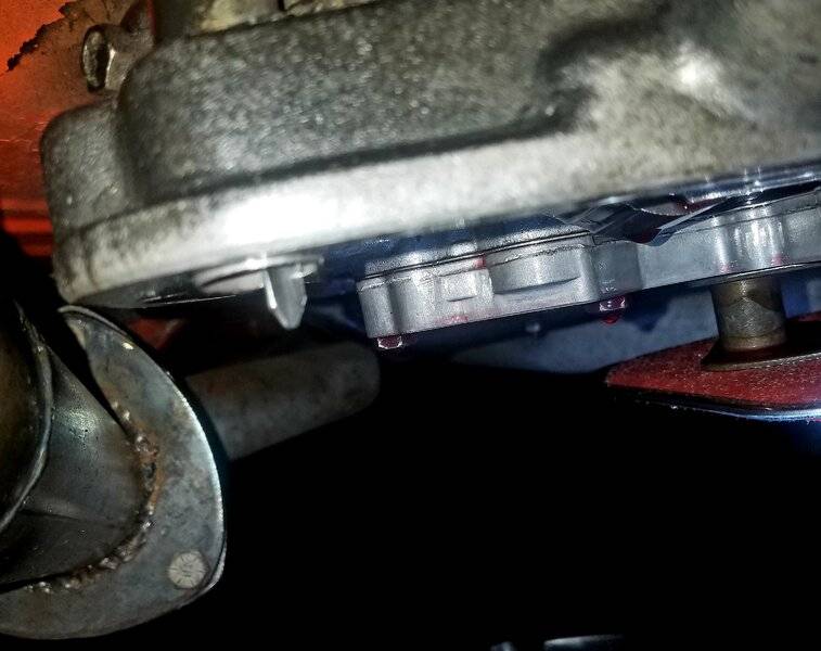

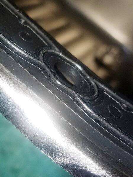

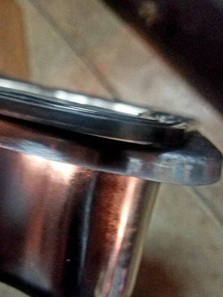

I've been having THIS problem exactly. I bought a deeper pan, shop I had to a Hagerty fire paint repair installed the pan, USING RTV!?? Isn't that a "NoNo"? So they had also put ATF+4 in it, from what Ive learned this is SYNTHETIC fluid, as with engines, synthetic say "50W"? Puts put a LOT of extra psi. Resulting in valve cover leaks Ive never had. Id beleive same goes for ATF? I drained 2 1/2 Gallons out of mine, (19 PINTS) including T.Converter...
Now its time to change the fluid, I am hoping the STP DEXRON II/MERCON fluid I bought will work fine? I know the damn pan holds 2 gallons!!
Also hoping this gasket from Global Transmission parts is as good as advertised?
A727/A518/A618/48RE "Molded Rubber", thing is 4.5mm or 1/8" thick..
Any advice greatly appreciated!
ATF+4 is not 50w. It has the consistency closer to water. So extra pressure ??? Dexron II/ Mercon are old school fluids and not a good as DexronVI . The new fluid types do not increase pressures but have additives that have less slippage/shudder properties. ATF+4 is totally compatible with the older 727/904 trans, Just more expensive.
Fluid level stressing the pan gasket and o-ring ? Make sure to have a good/new o-ring installed. Does your dipstick have an airtight seal when it is inserted in the tube ?? So why would there be stress on the gasket. Does the weight of the extra fluid put stress on the gasket ?? These arguments make no sense when you stop and think it thru.
You can install the molded gasket dry and tighten to 115 inch lbs per the factory service manual.

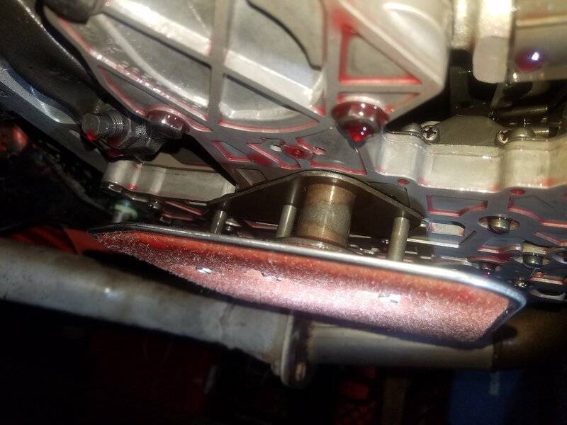

Yeah, I was comparing 50W MOTOR OIL to ATF+4, I have a 2-3/4" deep pan that a shop used RTV silicone sealant on.. Have pan off, all cleaned up with the best gasket, but not sure if I need to install a filter extension? Being that bottom of pan is 3/4" away from filter, and if only about 1/4" of dipstick extending PAST filler tube into pan is correct?
Could put all 19 pints of the ATF4 back into it I guess & hope for the best.
Thanks!
Does this appear to be correct, dipstick past tube? Depth?

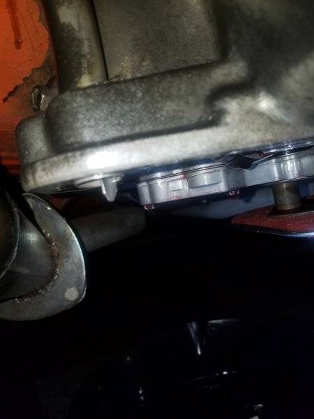

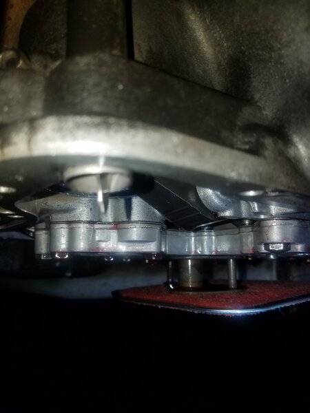

Would you say this, looks to be CORRECT dipstick depth PAST tube into pan?
May just go with the ATF+4, Some are saying the Dexron II/MERCON isn't so good these days, I also have a 2 3/4" deep pan. Seems like 19 pints total out of trans was a LOT!? If so, Im guessing my "Reading" on this 18 3/4" stick may need adjusted?
My filter is about 3/4" away from bottom of pan..

View attachment 1118787 View attachment 1118788 View attachment 1118789 View attachment 1118790
If that's the stock dipstick and tube that would be correct. The full mark doesn't change because you installed a deep pan and the level is above the gasket.

Think Id need make ANY adjustments? Say on Dipstick? Here's filter, looks like an extension?
yes, you have the filter extension

Wow, ya know, just seems so strange, that fluid running back UP INTO tube would be correct! I guess thats the way it works! These clowns using RTV is probably where my seepage comes from..
