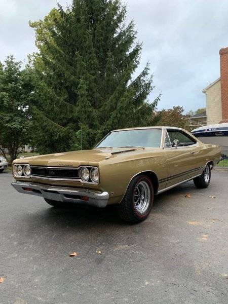

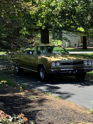

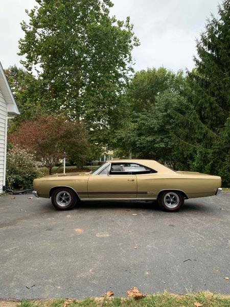

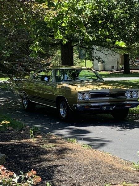

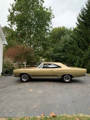

Need pictures of your car before the barbarians come for you.:lol:
:mob::xscuseless:
Thank you I do have a pressure gauge. And I mis-spoke. It shifts from 1st to 3rd skipping 2nd.
