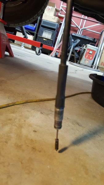

$275 for a cable?? He's smoking CRACK!

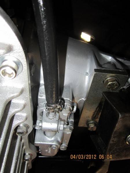

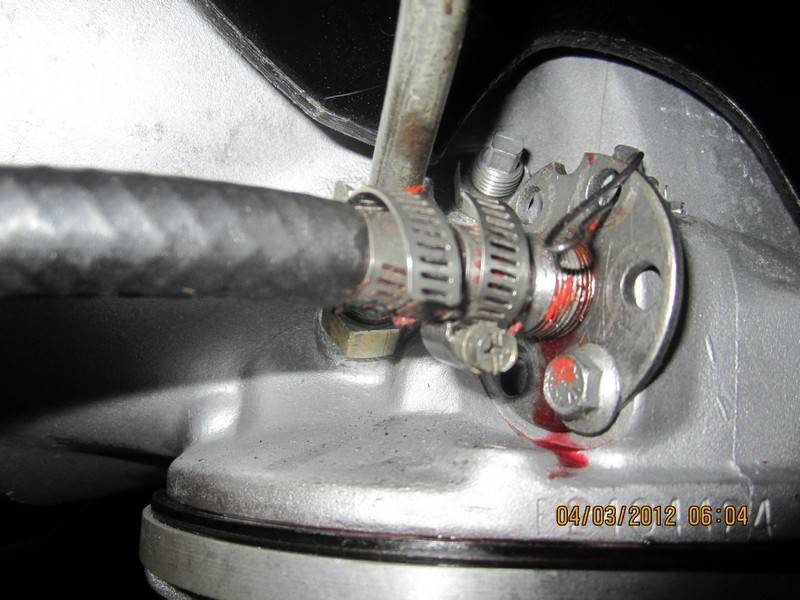

I hear that Kid!! I have rubber fuel line on both my cables with silicone on the trans end with small hose clamps.I know a few other guys like DVW that used shrink tube on the cable and stopped the leakage we all get.

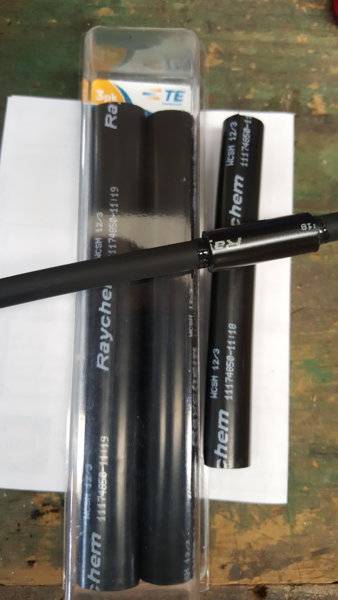

I used the shrink tubing with the glue inside. Got it from Lowes in the electrical section. Got the idea from DVW. Must be completely clean from any oil.

I also agree with the adhesive lines heat shrink tubing for repair. You can get 3-4'
lengths of that tubing online. Works best if you want to cover the whole cable.
