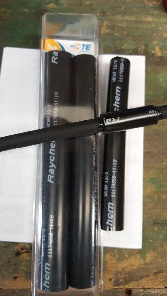

Heat shrink with the glue will seal leaking cables easily. I have some of it.
Doug
Doug
My Lowes has the shrink tube with the glue inside.
I do the metal crimped ends to the outer casing. And then you can repair any melted areas as well. That's all I've had to do.

Doug's heat shrink with glue works great. We used to have a puddle under the car all the time. It's dry as a bone after using this solution. Thanks again Doug!
