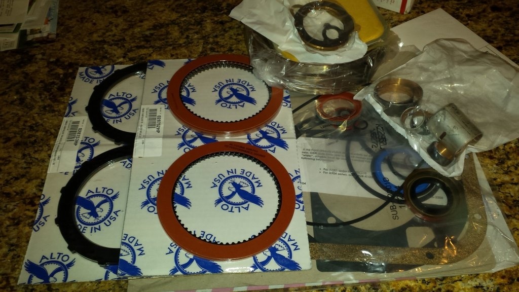

First set of goodies. Complete rebuild kit including shims and bushings.
