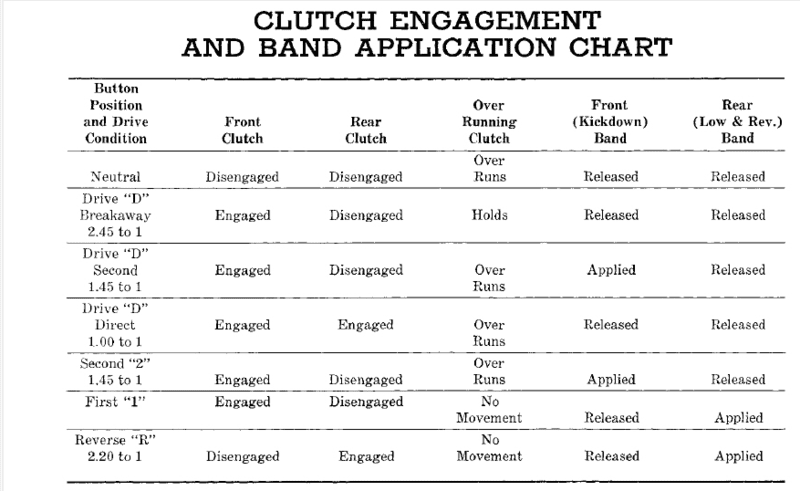

FWIW I hadn't caught the part about going forward in reverse & neutral... I agree it's a clutch that has failed... But it's the forward clutch...
What i it you don't understand B 3
The clutch names are misleading The "forward" clutch is actually located toward the rear of the 3rd/Rev clutch (direct as its named). We are talking about the same part.

"It will still be going forward when the selector is in reverse"
This statement may lead me away from a broken low/reverse band/servo piston. It's possible the rear clutch is seized.
Bingo !!
