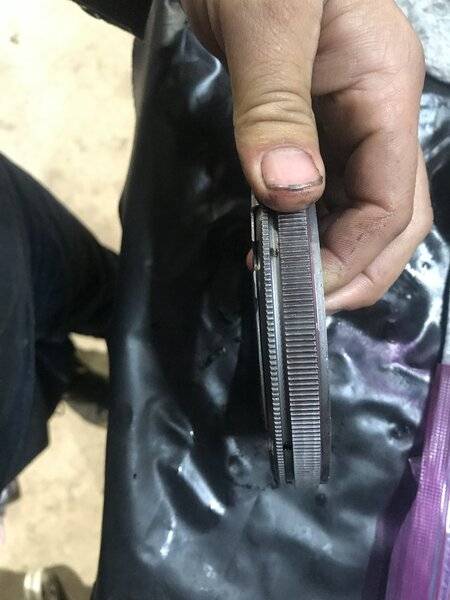

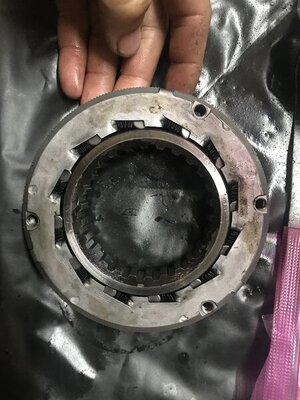

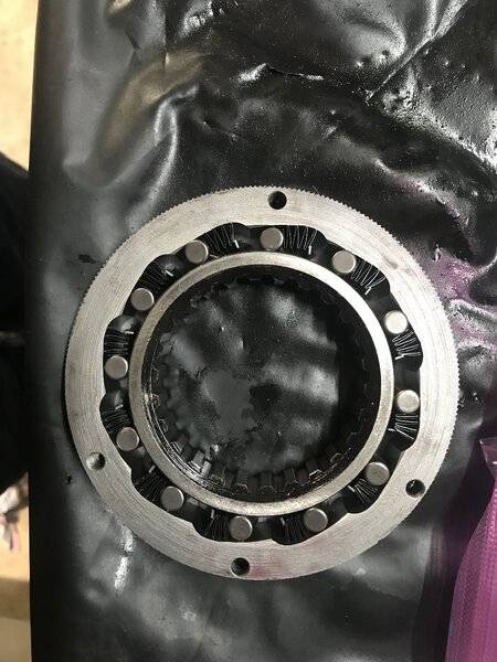

So I’ve removed the sprag to completely clean out the box. Anyone know what type/brand it is?
F3607EBC-FE82-49E8-B460-3F27886ECD7D.jpeg 86A8F3AA-8DF0-469A-B6D4-7FACDA1882D0.jpeg 77EEF276-4F7A-4CD6-A0CA-7F412C899177.jpeg
Was it just pressed into the case or was it bolt-in unit? If it was just pressed in with a
allen set screw holding it at the bottom it's probably stock. Clean it and inspect the rollers,
springs. and the outer race. If everything looks good, put it back. Note and take pictures
of the way the springs are installed. Remember, the springs always push the rollers uphill!
The inner race should only turn in one direction.
That is a generic bolt in sprag. It was originally developed to repair cases that were damaged. It uses stock rollers and springs. The only upgrade is a Super Sprag sold by A&A, Cope, ATI, ect. They are $200 US.

Ah I think that will be good enough for what I’m doing. cheers.
