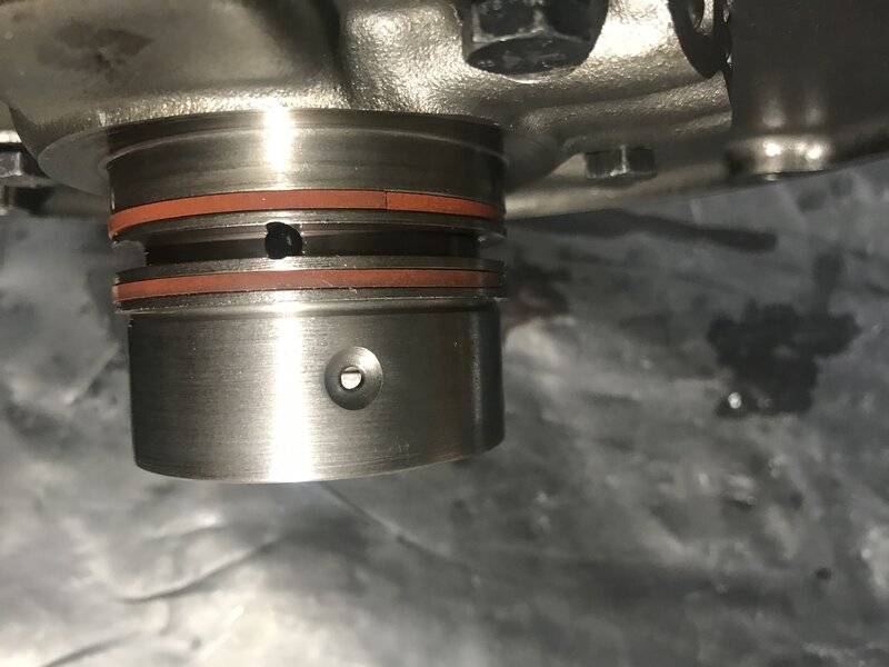

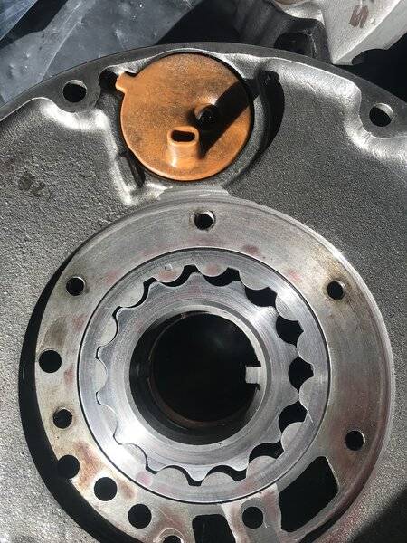

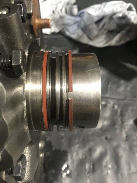

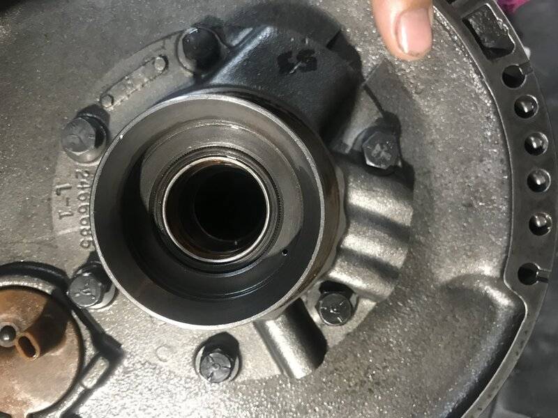

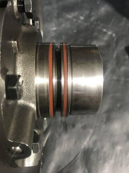

Good news! You've got the better wide stator support and wide bushing in the drum. How do the pump rotors look?
Those are teflon seals on the snout, but they are flush-cut. The newer ones are "Scarf-cut" which means they are
cut at an angle and overlap each other. Less leakage. How do the bronze bushings look?
The wide support needs the wide bushing front drum. Properly installed the teflon seals are great. Look at the pump rotors then measure the tip clearance on each. The stock OEM range is excellent.
no worries. I see that in the service manual. Will give it a crack and see how we go

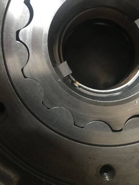

I will have to get a hold of some smaller feeler gauges to get in there. But it seems pretty good.
If the rotors aren't all nicked and grooved they will measure fine. Same with the pump housing. The pump and gears have to be pretty beat to cause an issue.

I'd listen to dvw, sure knows his stuff. But the pic sure looks like a bit of wear.

Measured it all up. All well within spec.
In my years building 727's, I think I've needed to replace one set of pump rotors that had a lot of damage, nicks/gouges. Maybe a couple of pump housings that had wear that concerned me. Even the 727's when I broke the convertor didn't really affect the pump. The valve body may be another issue though. I'd be looking for a new valve body to match your application.

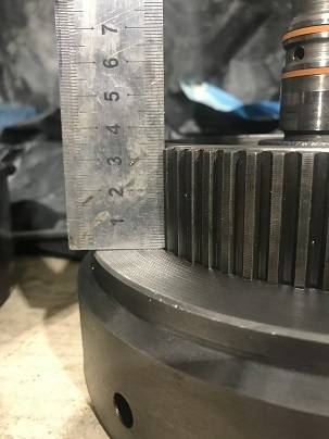

Spoke to John this morning. Pretty keen on his stuff now. One thing I did notice on the input shaft is where the 20mm wide bushing in the drum sits, it appears the shaft is only 15mm.it’s wider but the bushing has only been wearing on 15mm due to the step. Is that a mismatch? New shaft?
