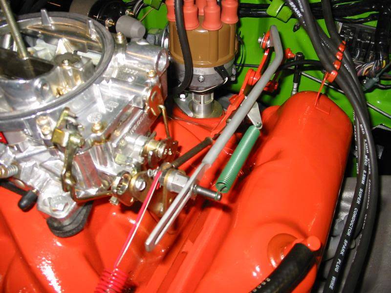

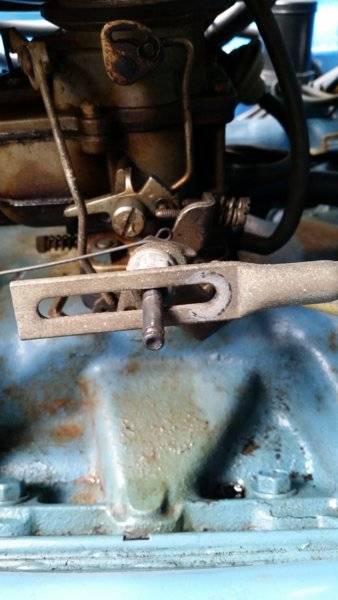

The back of the kickdown linkage slot should be almost touching the linkage pin. (if you catch my drift)
The first photo is what it is NOT supposed to look like. The second one is correct. Start there and fine tune as needed.
