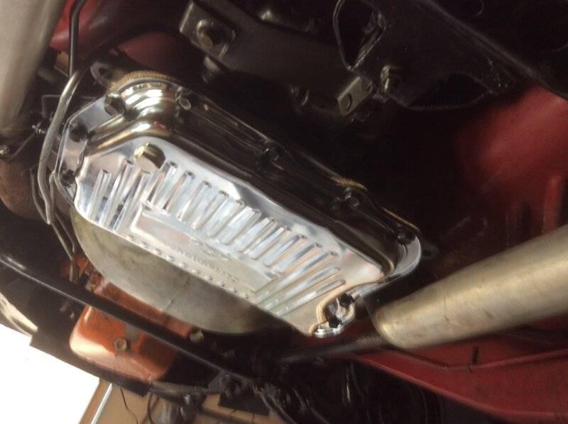

Bought same one. It's OK for a cheap pan, Glued gasket to pan and let dry some then to top of gasket. Had to really tighten drain plug to stop drop forming. Ok if funds are tight. I'm just cheap.:rolleyes:
Picture added.

View attachment 975435 Bought same one. It's OK for a cheap pan, Glued gasket to pan and let dry some then to top of gasket. Had to really tighten drain plug to stop drop forming. Ok if funds are tight. I'm just cheap.:rolleyes:
Picture added.
I bought the same one!! It was that pan for about $30 or a factory looking pan for $80. It works good with a cork gasket glued to the pan.
