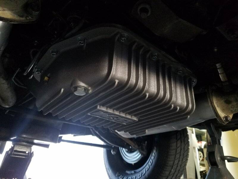

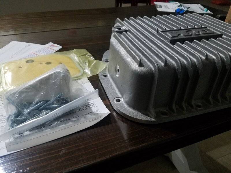

This thread peaked my interest so I bought this badboy to try out. I like the solid rails that theoretically should seal more evenly than the stamped pan.
It's in and ready for driving. :)
How has this B&M pan worked out for you? Are you happy with it?
My stock pan is leaking badly now. All the bolts feel very tight, so they have all probably been over torqued by a previous owner. I also suspect the gasket and filter haven’t been changed in 20 years..
I love it. No leaks at the gasket. Very well built piece. Bolt holes can strip easy if overtorqued. I have a set of helicoil repair inserts for when another lets loose.
