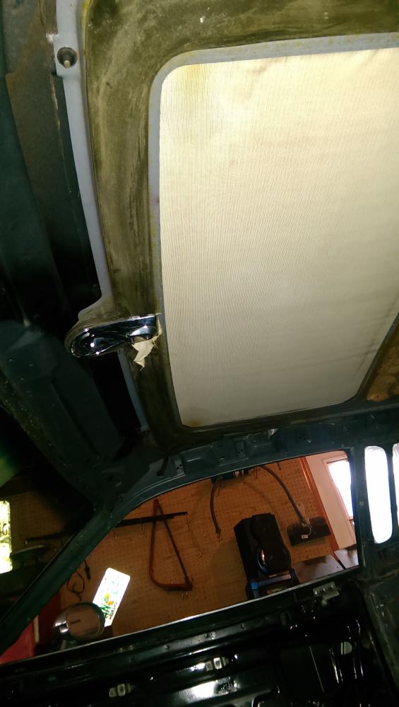

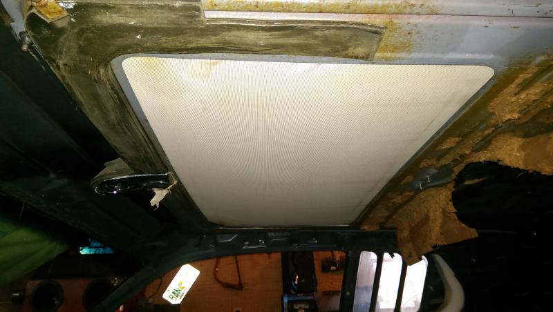

Could someone share some pictures of their sunroof from inside? I see lots of pictures from outside the car showing the roof open but I can't find any good ones from inside. As you can see from my picture, my 74 roadrunner is missing the headliner and the crank bezel. I am hoping some good pictures from you guys will help me see what else is missing. Since the bezel is hard to come by I want to see if the charger and roadrunner one is the same so I can expand my search. Of course my sunroof doesn't work either, I can feel the gears skipping, so I'll be needing more than just a bezel in the long run. If I found a whole set up I'd be happy too. Thanks in advance.

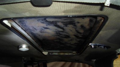

I can get more pictures tomorrow if needed my car is 100% org and unmolested and in perfect condition and works like it's new so I have the perfect car for pictures

Thanks. Those pictures help. i might have to pick your brain later, when I get on to it. How did your dome light wiring route? Mine is clipped on the edge of the sunroof so I am sure it was moved when someone monkeyed with the sunroof before. The wiring seems too short to reach to a more logical place. Did you have pictures before the headliner was taken out? I'm curious to see what it looked like.

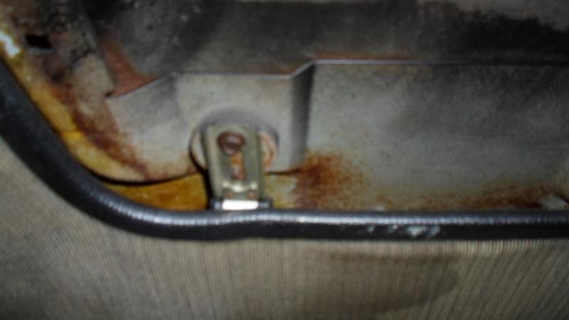

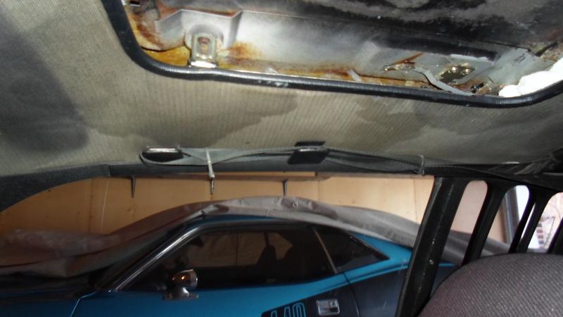

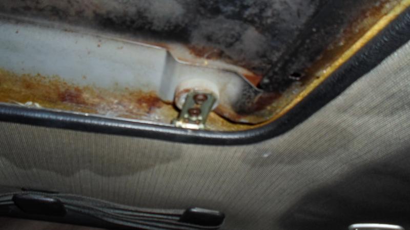

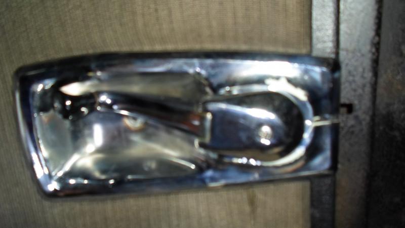

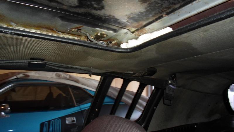

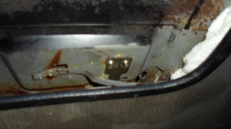

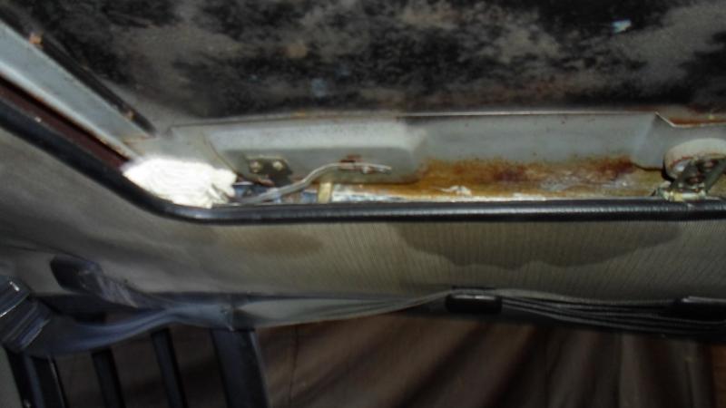

Hi Root,
Here are the pictures I took today. Sorry my garage is dark and the pictures didn't turn out too well. That picture of the black bezel is the one I bought on Ebay, but it doesn't fit my Charger. Not sure what it does fit. These numbers were on the back of it: 3696965 and 68072. Hope this helps.
BTW Those white things are just towels I stuffed in there to prop the plate up. As you can see I need a new headliner too.
440rush, Thanks! Those pictures are exactly what I was looking for.
Regarding that bezel... The chrome one in your picture looks kinda squared off on the side away from the crank whereas the black one is rounder. The rounder one looks like it would match the curve of the foam you can see in my picture. Also a user on this forum has an older forsale ad in the parts section for a whole roof from a sunroof charger. The bezel in his pictures looks rounded off too.
How i.e. did the black one not fit? Too small or shape? Does the squared off one work? If so what did that come off of?

All go out tomorrow to check the wiring route the headliner was ripped down like the picture shows when I got it

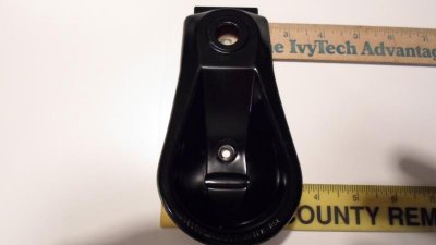

Hi Root2812, The chrome bezel is the one that came with the Charger. They are shaped a little different like you said. I bought the black one on Ebay, it was advertised for a 73 Charger. It was close to fitting my Charger but just off a bit,so I'll just go with the chrome one for now. It's not that bad of shape & I don't think I will replace my headliner anytime soon. The black might fit with a little work. It kind of looks like your picture & the picture Bb700Charger500 posted have the rounder bezel unlike the chrome on that's in my car. Do you think the black one will fit your car ? I could send more pictures if you like. The chrome picture was a little blurry.

Root 2812, The black bezel was the wrong shape but very close to the right size. I don't need the black bezel if your interested LMK.

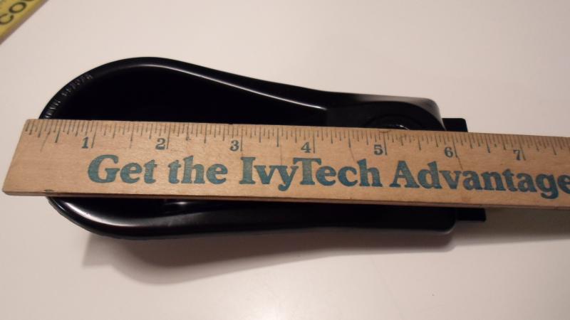

I wouldn't mind a few pictures with some measurements. Maybe Bb70charger500 could compare those measurements to his bezel. If its the same as what I need or will atleast work I would be interested. If I painted it white it would look just fine until I found a real chrome one.
I'll get pictures of both the chrome & black one as soon as I can.Work got crazy so it might a few days.The black bezel was made of white plastic when I bought it but I painted it black to match my interior. Maybe it could be plated ?

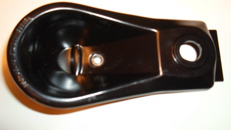

Hi Root2812, Here is a picture of the bezel I have. If you're interested in it,I would take $30 plus shipping. That is about what I paid for it a few years ago. Thanks
