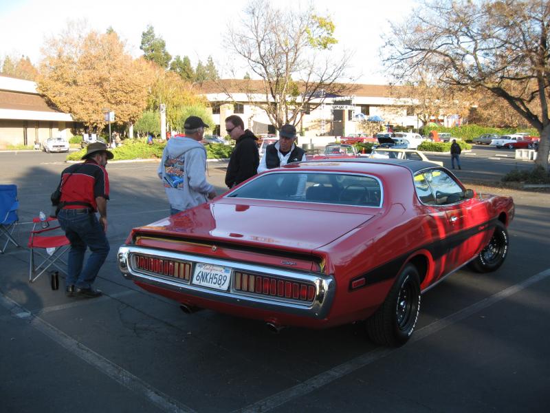

IMHO, nothing. It looks as if there is something missing with out the fillers on a 73-4. But that is just MHO.
ODZKing is correct. It does look as if something is missing unless you have the chrome body trim around the bumper which helps for a more finished look.

Even if they are pulled in with the earlier brackets? The pic is of a 73. The filler has an odd look, but normal. ToyDriveCarShowNovember23,2013 016.jpg
