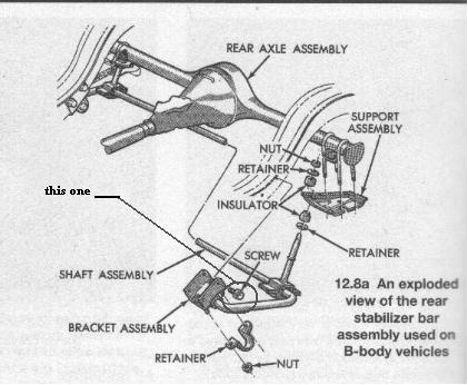

Acturally, I'm wrong about the swaybar. The swaybar mounts swings around to the outsid

I was incorrect about the sway bar. The sway bar mount under the axle and onto the frame. If you move the spring perches mounts inwards, you just need to slide the strut bar inwards. Simple.
