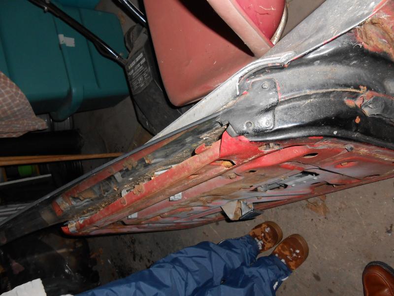

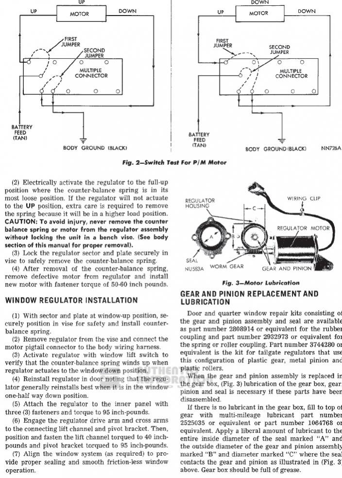

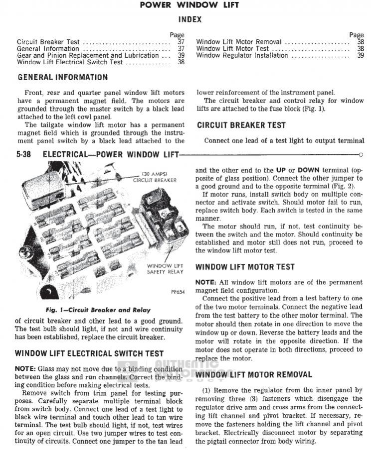

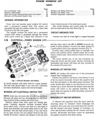

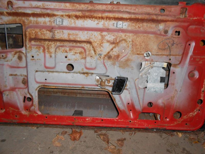

All should bolt up, just a matter of getting it in there. I snagged a door a long while ago as I need the glass. Took everything out of it but before I did I snapped a few pics of it, here they are if it will help. A service manual would be helpful as well. I don't have a Plymouth but should be the same as my Charger so go to my site and download it.
http://www.retrorarities.com/images/73DodgeServiceManual.zip
