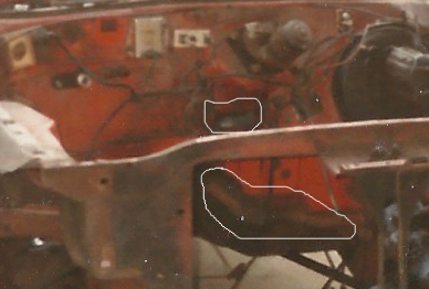

I had two 73's, one Satellite, one a Runner( make sure the VIN is RM-all Runners are RM, check the fender tag as well). Both 318 cars. Don't let that detour you-318's are great motors and can be built to run like a big block WITHOUT the added weight. Check the rear wheel well openings good- lower quarters to the bumpers, and all the way forward to the rockers along the bottom is prone to rusting. Dog legs of the front fenders, and of course the lower door edges inside. Trunk floor and extensions. All typical Mopar rust out points. Check the inside of the rear bumper-if this bumper hasn't been redone that will indicate what kind of rust issues "could" be present, this area is often overlooked. Frame everywhere-especially around the torsion bars-poke at the floors from underneath in the footwell areas make sure they are solid-unless you can peel the carpet back(which is unlikely). Firewall above the trans. tunnel- below the wiper motor-there is a flap(*see pic), this is where water is released that enters along the lower windshield. If you can get your hand back there without scratching paint-check under that flap!! Make sure it is not clogged with debris, otherwise the lower cowl(*see big circled part in pic) will rot out-from standing water. Looks like a nice car. Have cash in pocket-start low and work your way up- I wouldn't go more than $7000-if all those areas on the body check out. Good Luck!

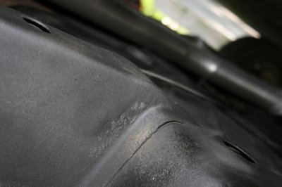

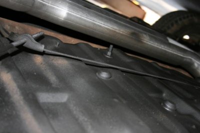

few pics of the underside
He sent me a few pics of the underside he said he put the new exhaust about 4 years ago

Looks like it's been repainted, which can be a little scary.
(they painted the seat nut and stud)
Looks like they didn't get all the original undercoating off- at least it looks like it had undercoating.
Those particular areas look solid.

Good call on the firewall flap.
For 9K, I'd take it through a car wash and check for cowl leaks, if you can't get your hand down in there.
A rusted cowl (very typical) will turn your 9K car into a 12K car REAL fast.

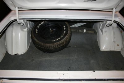

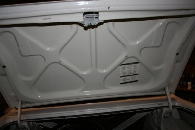

Yes it was repainted when redone 15 years ago i thought i wrote that in the original post maybe i missed it also he said he had it re undercoated around that time as well. I think I forgot new tires new brakes all around new u joints and the flow master 2.5 in dual exhaust which he said was around 3 years old but looks newer than that to me it doesn't even have surface rust on it and he said he replaced the original valve cover gaskets recently as well since they were starting to leak a little. I hope the body is in great shape so it makes it a no brainer we'll see I guess.
4 more pics
I had 4 more pics 2 engine bays and 2 truck pics but can only get the trunks to load right now will try the bay pics again tomorrow . Also the owner told me it is factory ac which he had converted to 134a last year and blows ice cold also factory hood pins and factory front and rear sway bar though I'm not sure if they all had that or if it was an option.

Trunk's the wrong color, too.
