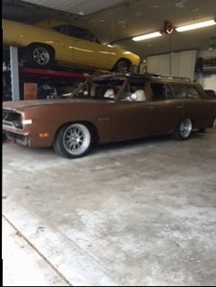

73 Satellite wagon update.
What gauges are those in your "new" guage cluster?
Stock gauges. I found a housing that had the 4 gauges in the small pods, and the optional clock. I swapped the clock for a repro tach IIRC R/T Specialties, and used a early 150 speedo. to make them easier for me to see at night I slapped a cheapo stick on white gauge face set and painted the needles bright red. I want to eventually take the bulb filters off and use drop in red LED's.

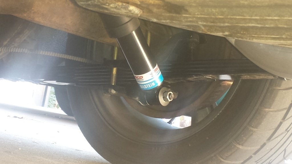

Didn't get quite as much done as I wanted during my vacation but did get a couple things bolted up. Put the new leafs in. Sits a little low, so considering getting them re-arched, or adding 1 more full length leaf.

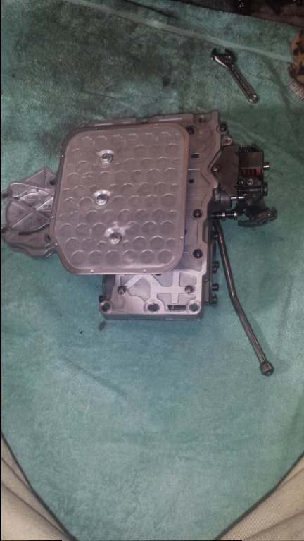

The 904 was getting over-run by the 340, so decided to kit it until I can find all I need for the manual trans swap. Oh what a difference, got the TF2 and did a combo of mods to get the shifting how I like it. Its smooth while cruising, yet still instantaneous. Past 1/2 throttle its bark the tires on both the 1-2, and 2-3 upshifts. Sooooo much fun to drive now.

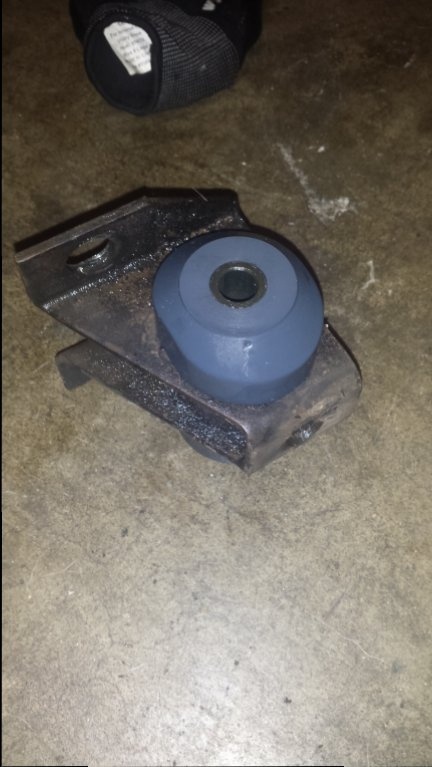

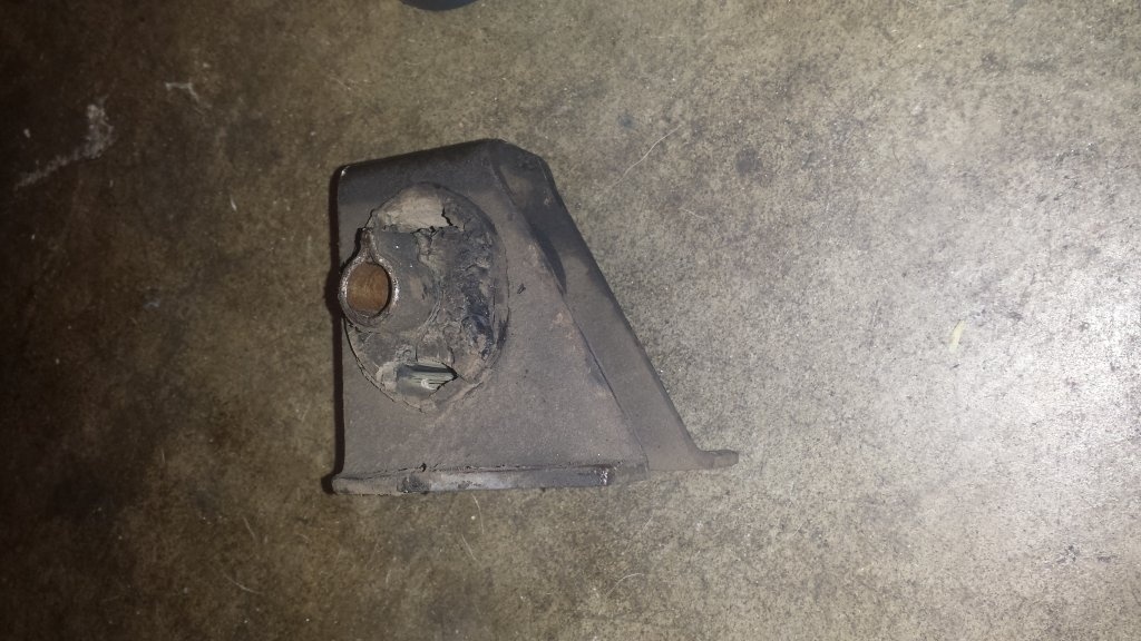

Trans mount had seen better days.
Your wagon looks slick sitting just the way it is. But you are right on adding a leaf or doing the re-arch so you can get some load capacity.

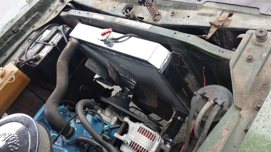

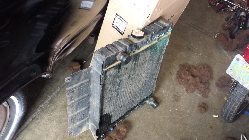

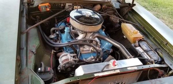

Finally got a little more work in. Been taking longer trips and even in the cool weather the temp would start to rise. The old 18" 2 row rad just isn't up to snuff, and will be nothing but trouble towing 2k #'s in the Summer. Got a Chumpion, er, Champion 4 row rad off of fleabay. Had to do some minor trimming on the lower bracket but it doesn't leak I took a run up the mountain and the gauge didn't move off 180. Now to find or make a shroud. :-/
When I pulled up to the house though the oil filter adapter seal blew and puked oil on the header. Swapped the poor fitting stamped piece for a iron 90 degree bit I had on the shelf.

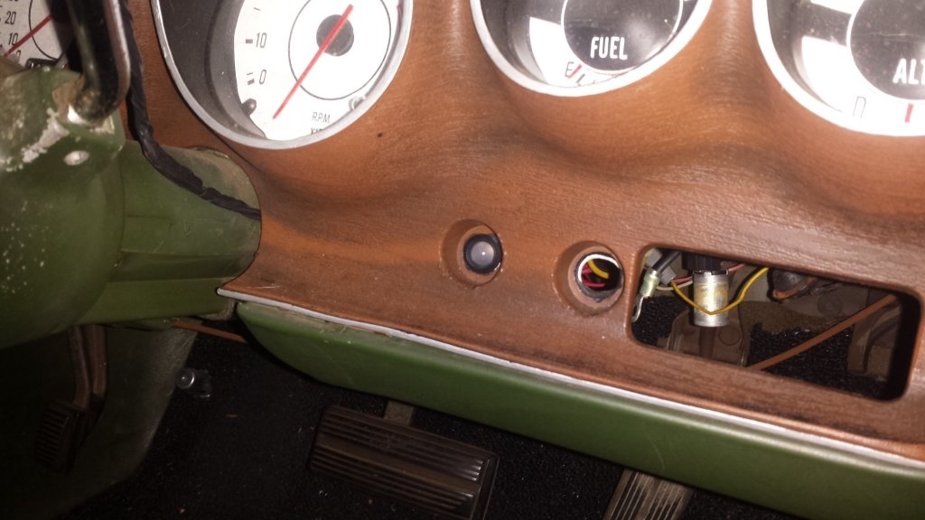

With the alternator upgrade I ran the charge line to the starter relay effectively rendering the ammeter useless. I found a outfit in the UK that makes a multi color LED in 14mm meant for monitoring the charge system for old British bikes. It snapped in perfectly where the OEM radio went. Red for discharge, green for charging, yellow for overcharging.

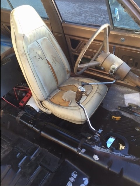

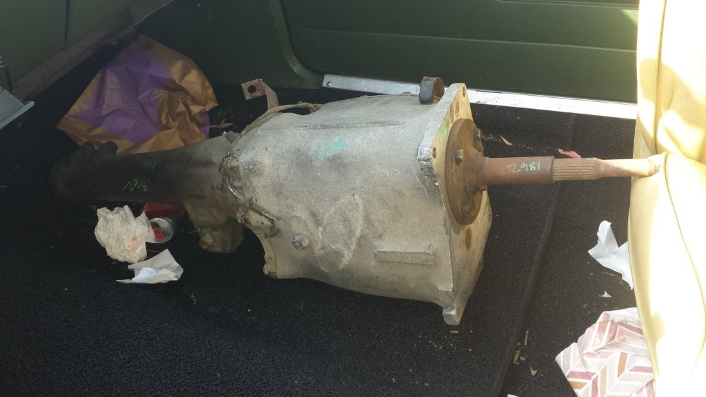

Scored a 4 speed trans, but still need everything else. Going to stuff it with the gear set from Passon and go back to the 4.10's in the rear.
