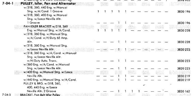

Want to replace idler pulley. Car has two belts. Original pulley about 1.5 inches wide, diameter 4 inches.Ordered “correct “ pulley from Rock Auto diameter right, width 1 inch, would work with single belt. Napa part same.
Any idea who might sell correct one ? Think part # is 3830 162, if I read my part book correctly.

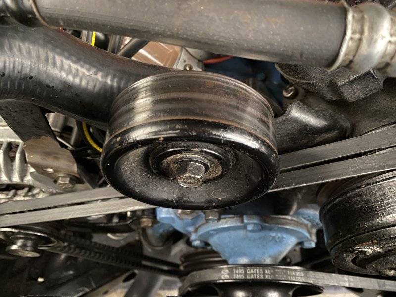

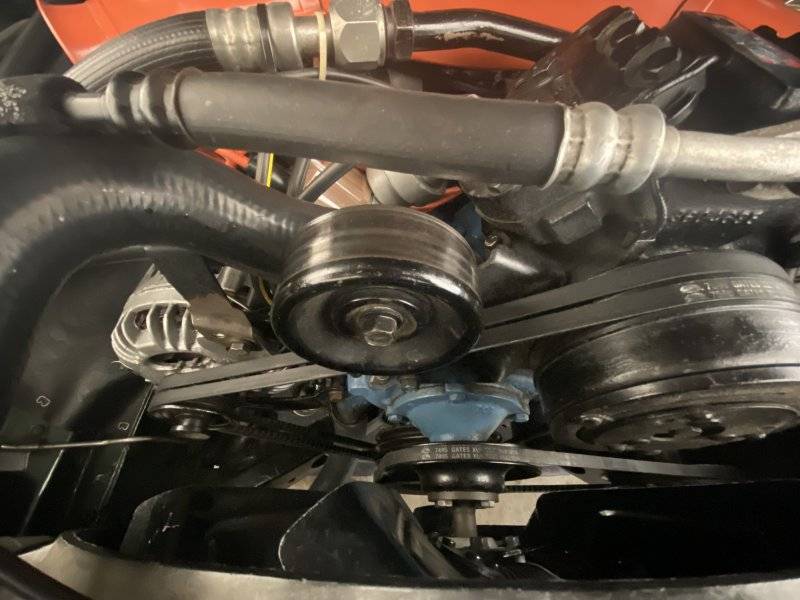

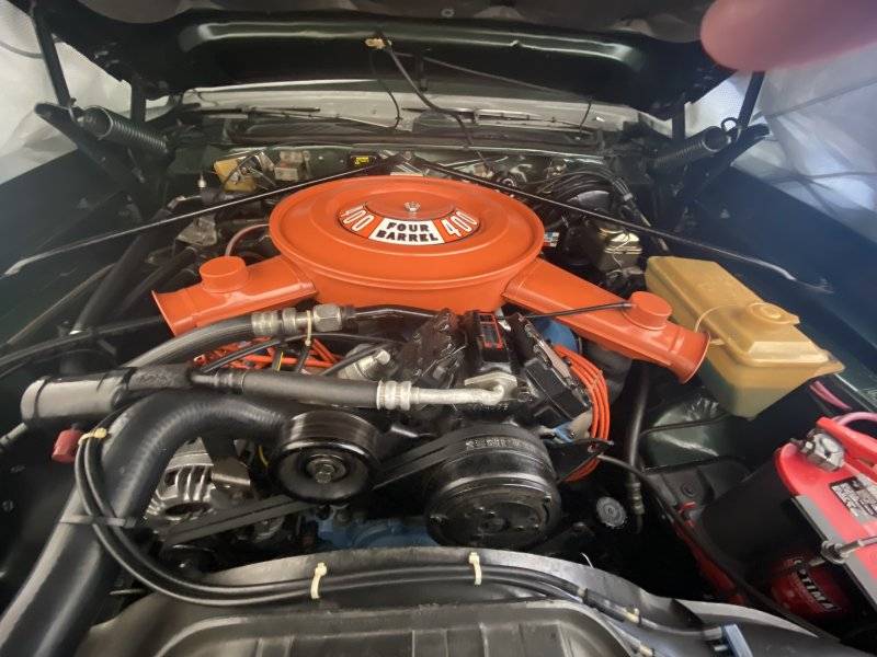

OK,here are pics. BTW confident P/N is 3830162,haven’t found one.

Good thought, have to investigate, have to find some one to do it, way above skill level.attached some pics, believe P/N 3830162 . Thanks

Good idea, have to search for some one who could it, don’t have a drill press and above skill level. Attached some pics of pulley, it’s really a tensioner.
That number is not available. Myself I would remove it and run without it. All the Chrysler cars in that year did not use it. Plus millions of others did not use that set up. No rhyme or reason. Or you can take it off and look for any numbers on the steel part along with a bearing number. With the bearing number you could possibly find a bearing and get it pressed in.

I concur.....run without the idler pulley. Older vehicles with A/C did not use this arrangement but a different water pump drive arrangement.....perhaps 1970 and older B and RB engines. The slight loss (~ 4° contact angle with compressor clutch drive sheave) and MIGHT require slightly shorter drive belts or perhaps the difference can be taken up by the alternator adjustment (greater or more travel) ....... just a thought....
