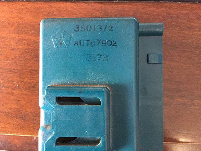

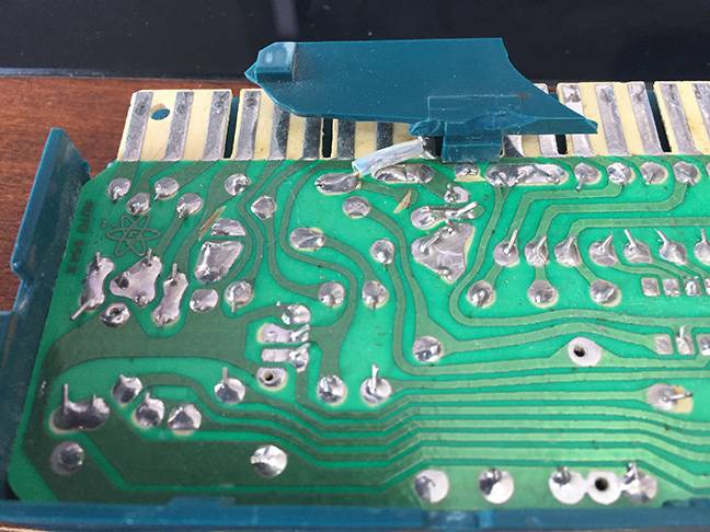

Not all Canadian cars have the orange box. Nacho, I think you mentioned this on another forum. I have a 74 built at the Lynch Rd. plant on November 30, and it has a green (or teal) box and no reset button. I dropped the box taking it off and the case broke, but at least you can see inside. Notice the jumper wire. I wonder what the difference is with the orange box and if I could use an orange one.

Maybe that unit could be replaced ?. Is a Faded/yellowished blue one, not green. I have same one with a jumper too around, not just the one I pictured. But AS FAR I KNOW some of these boxes were modified at dealers due constant failures. Some units got a paint mark when modified I think.

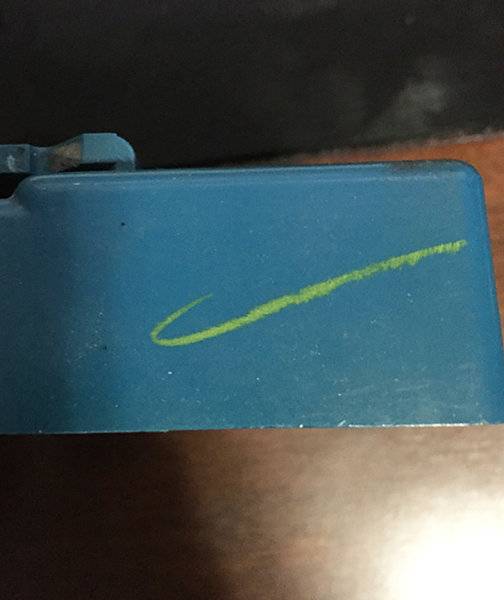

So that's why some of the boxes are painted. Interesting. I guess seeing the wire on mine could mean it was modified. Funny thing, I can't find the part number 3501372 in the parts book. I have seen one on ebay and it had a paint dab on it.
I have seen some with white marks and some with a yellow dot painted. I have one with a yellow dot. I really CAN'T tell which is the reason why is that. This is just what I have read... somewhere.

Ok, I have one blue 3501372 with same jumper and the white mark on a corner, sprayed. My catalog shows 3501371 and shows it as a new number not listed on a previous catalog ( and date after 2-01-74 ) and is the ORANGE box
The other one is blue 3746658 without any jumper and got a yellow mark, BUT aplied with a brush or something similar, ( not spray ) Not on my catalog. ALTHOUGH the 8 could be a 3 dripped when printing ?.
And the NOS one ( blue ) is 3746653, none mark on it. This PN is on my parts manual catalog ( up to 11-1-73 )

and actually the "jumper" is a diode leg on back side, which reachs another part of the circuit on the other diode end ( to a transistor end ).
So it seems is NOT A STRAIGHT and pure jumper.
You can see the jumper in the ebay photo with the box. I've seen both of those. Mine doesn't have paint dabs, but does have a yellow mark that sort of looks like a check mark. Maybe the tech that modified mine was lazy and just used a paint pen. I'm sure the parts book was printed before the mods were done and that is why the part number isn't in them. It's only one number higher. Thanks for your help with this.
