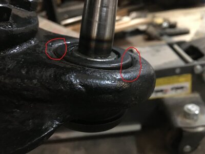

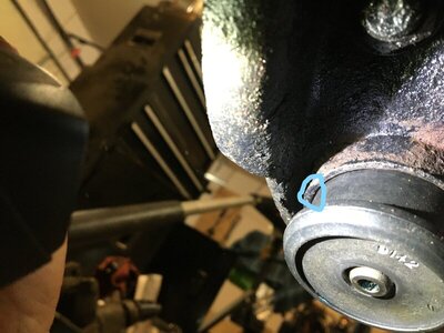

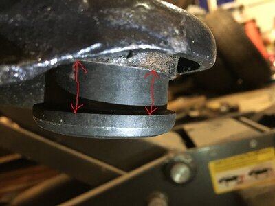

Hello everyone. I am in the process of replacing my lower control arm ball joint (Moog K7069) on my 74 Satellite and wanted to get some opinions before I install the tie rods and steering knuckle. Upon installation, I am noticing a very narrow gap on the underside of the control arm between my ball joint and the lip of the underside of the control arm (See circle in IMG 257). The gap is only present in one spot, not all the way around the lip. Also, looking at the ball joint flange (The top side of the ball joint where the zerk fitting would go), the distance between the flange and the lip on the underside of the control arm is not the same around the ball joint (See arrows on IMG 260). Looking on the top side of the control arm, the profile of the ball joint exiting the control arm is not the same around the rim (see circles in IMG 259). My questions are: Is this normal? I installed the ball joint the first time, noticed the same issues that I discussed above, removed the ball joint, and installed again, being careful to install properly. I got the same result. Is the lower control arm warped? I see no cracks in the control arm. Am I just being ridiculous? Thank you all in advance. This is my first restoration, so I'm still learning a lot. I just don't want the control arm to crack while I am driving it 10 years from now when I finish the car.

Are those pics before you finish pressing the ball joint on all the way?
That's a very good question. Long story, just warning you. So when I began working on the ball joints, I looked at what was already on there as a reference. A previous owner installed them the last time who knows how long ago. Both driver and passenger lower control arm ball joints were not pressed in up to the collar, so I assumed that was normal, although I thought it seemed odd that was the case. Anyway, I attempted to install the driver lower ball joint and what you see in the pictures is where I could no longer press it in. It felt like I hit a wall with the ball joint press. After my initial post, I moved to the passenger side and was able to press the lower ball joint all the way up to the collar. So, I am concluding that the previous owner did not install the ball joints properly. I'm wondering if my issue installing the driver side one was because I was not installing at the proper angle, which led to what I showed in the pictures. I ordered a new ball joint and am going to try again on the driver side, being sure to start installing at the correct angle.

no problem, I’m happy it helped! Good luck getting the drivers side sorted out - if it keeps seating at that same angle I’m wondering if the bore for the ball joint might be oval-ed out or otherwise warped from a bend in the control arm.
If the ball joint does not go in straight you will have trouble
Set your press up so you can push with out the joint cocking like the one shot
Put joint in freezer and the control arm in the sun or oven if allowed but not to hot it should be easier
