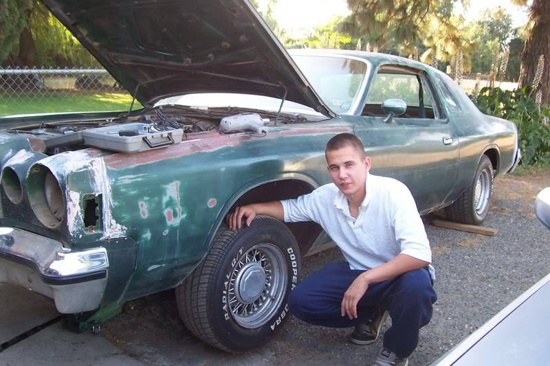

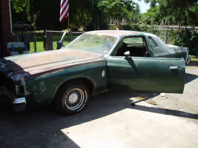

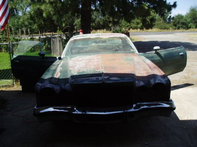

Hi, I'm new here. I just wanted to post picks of my build. A while back a friend of mine past away and left me his 1975 Chrysler Cordoba. It ran, but wasn't in perfect shape. the vinyl top was faded and cracking, the paint was worn and you could see lots of primer, seats were ripped and faded, rims were rusted over. But the car ran great, and was completely stock. My friend loved this car, i love this car. I am trying to restore it. I'm no mechanic, but I'm learning ALL of this as I go. Some stuff I am doing right, some it takes a few tries. Here we go

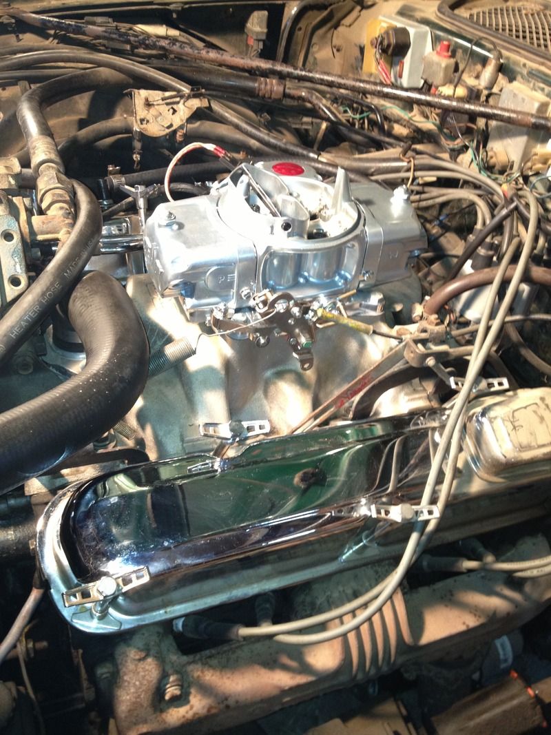

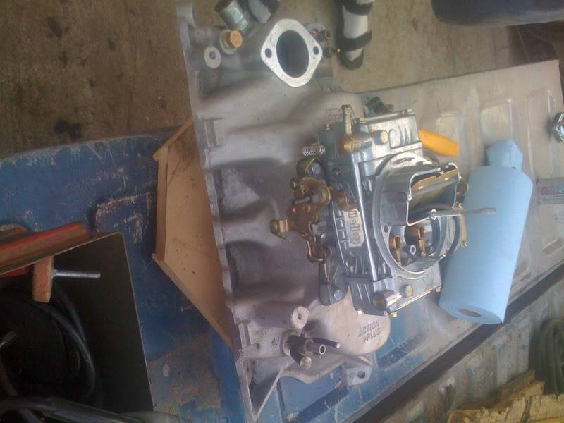

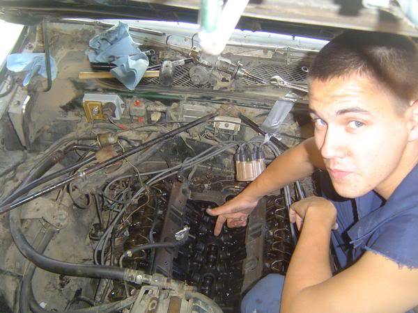

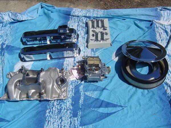

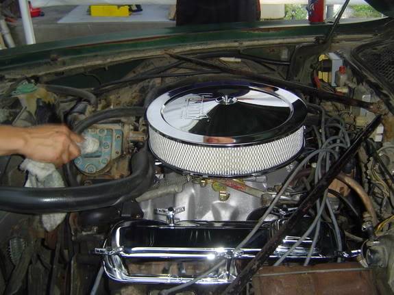

First up had to do some work on the engine. Stock 360ci with 2barrel carb. I took the stock intake manifold off, and upgraded to a Weiand high rise with a Holley 4 Barrel Carb, and chrome dress up

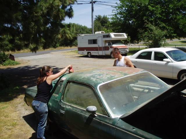

My wife was gettin in there to help too.

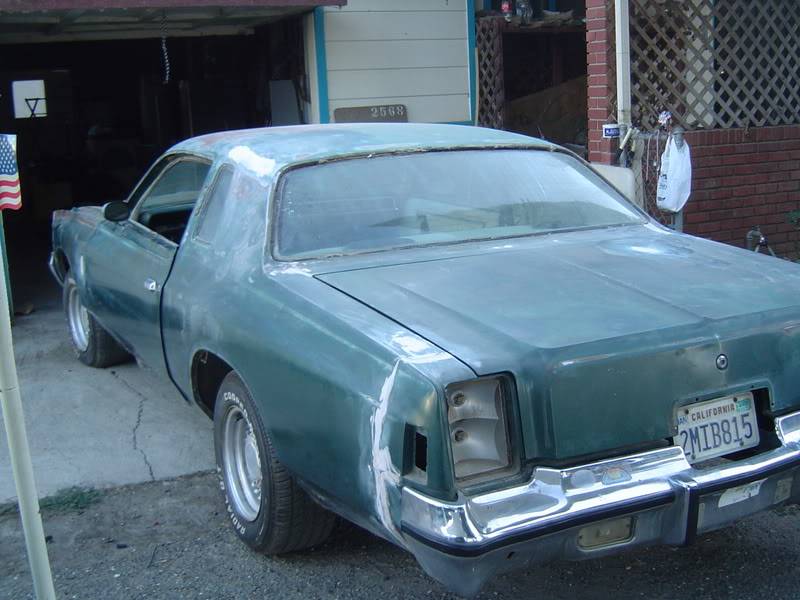

A lot of body work is needed before paint. (Yellow was the only filler primer they had)
My mom even slapped some primer on.

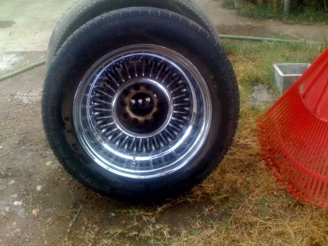

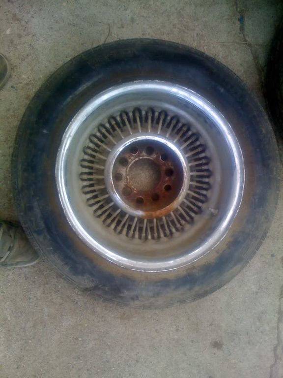

This is a LOW budget build. Needed some new shoes. This is what i got
This is the same rim after some elbow work.

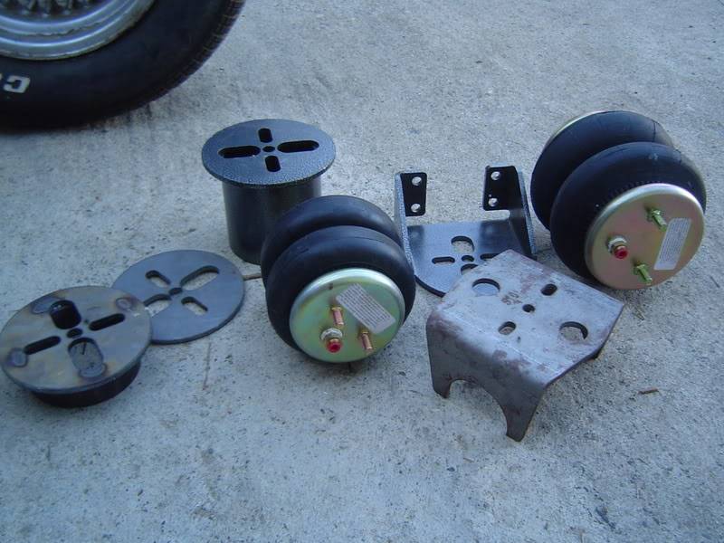

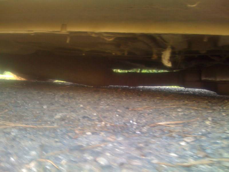

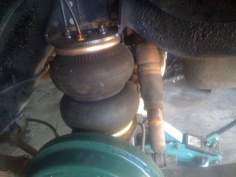

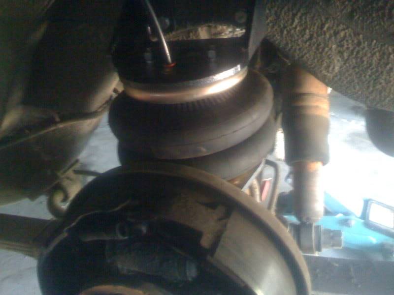

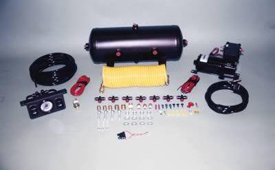

Now I wanted to put it on air.
Down
Up
Air control

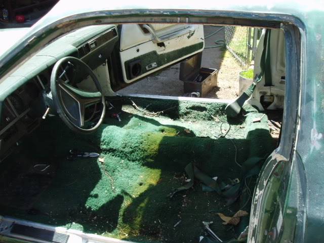

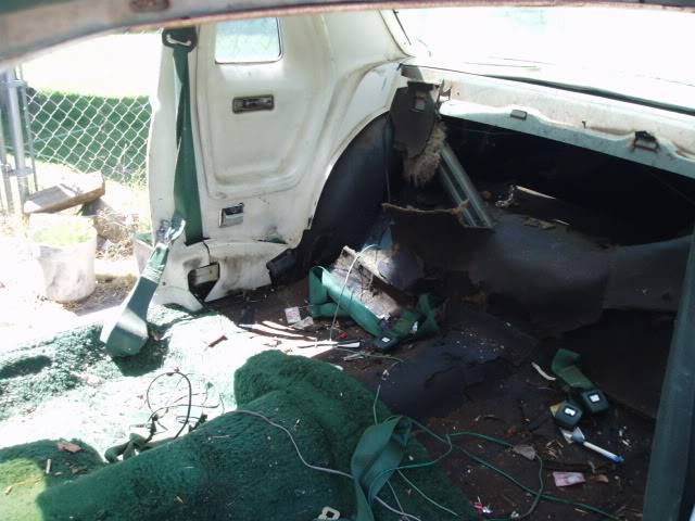

A little interior work
Seats out
New rear seat...i have a couple front seats, dont know which style im going to use.

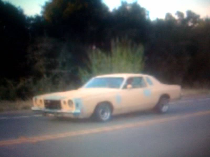

Test run

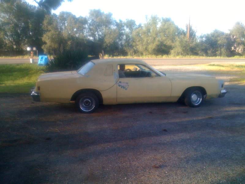

Sittin with the *** down
Sits a little low

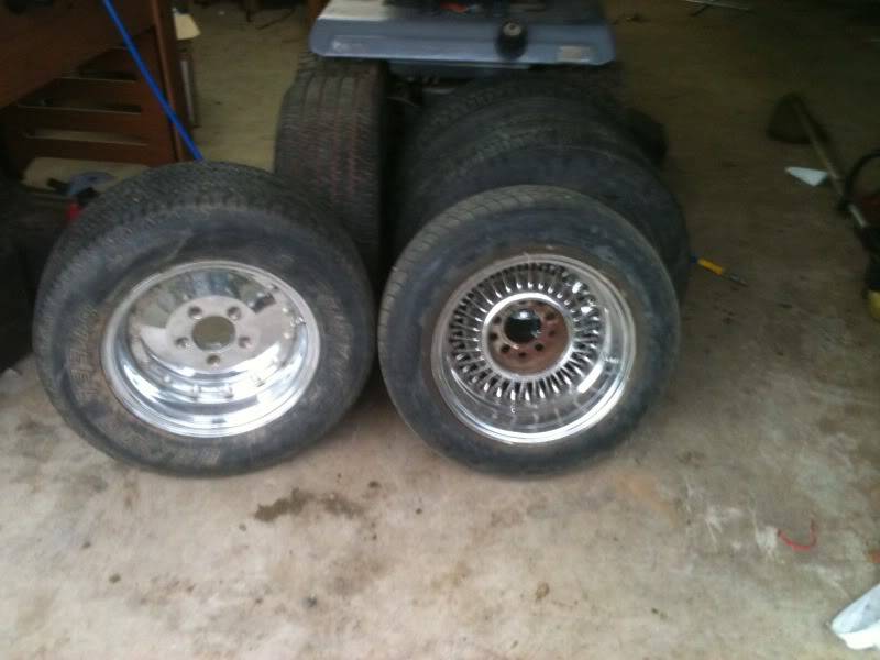

Switched away from the wire wheels still waiting to be put on, but..

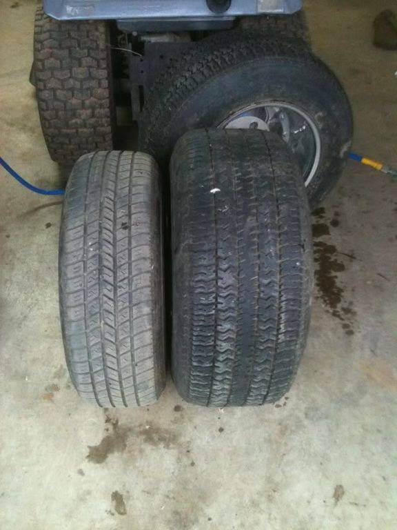

Front wheels old vs new
Rear wheels old vs new

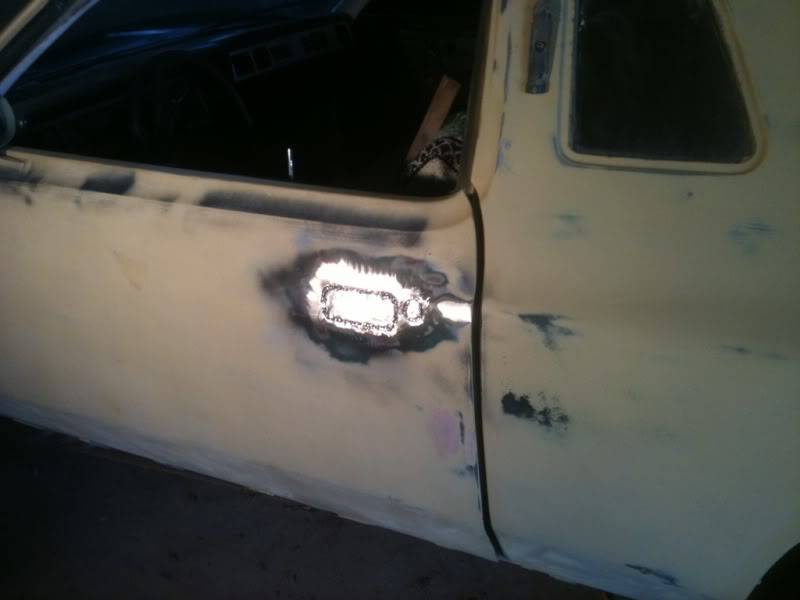

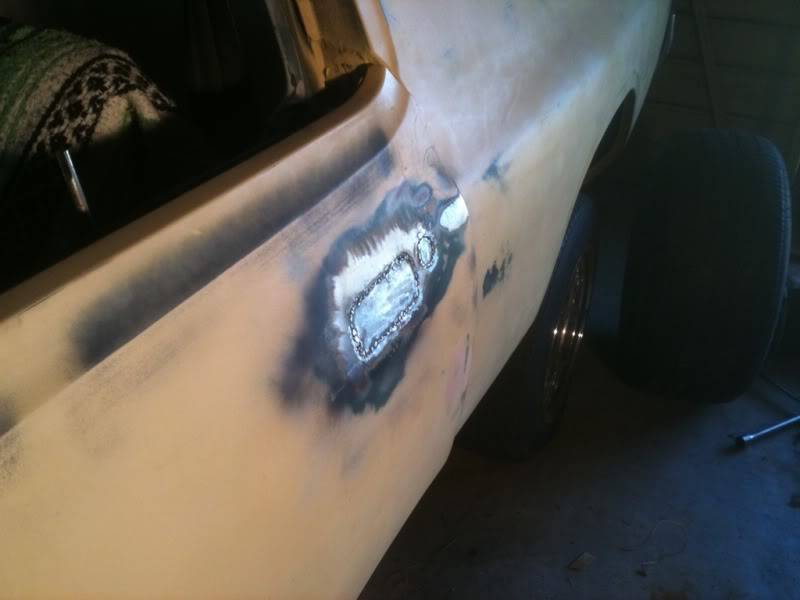

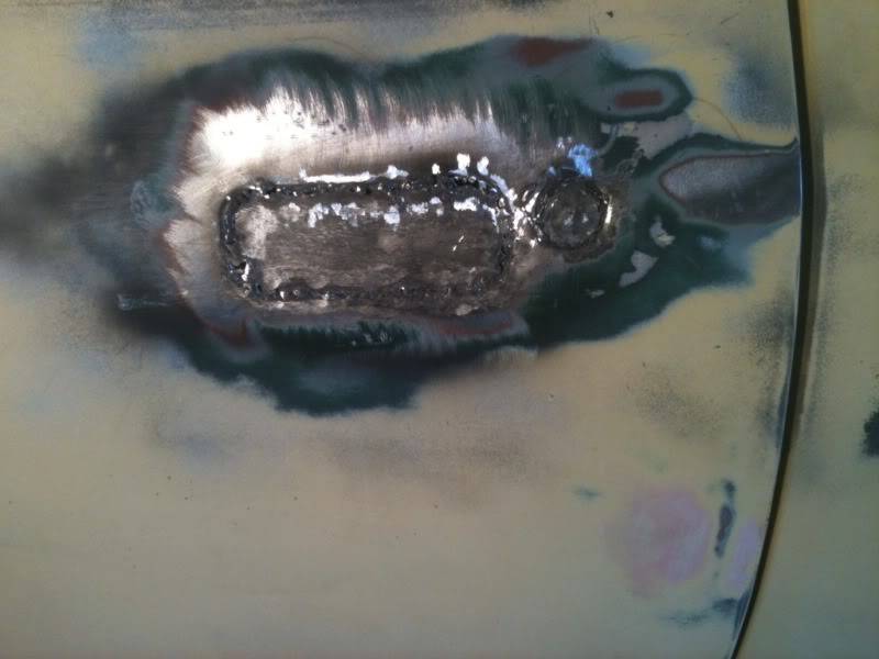

I recently got a welder, and I practiced a little and tried welding over the door handles for the shaved door kit. It isnt a pro job, it may be ugly, but it should work.

I love the shaved look. I dont plan on putting any of the mouldings back on. I want it sleek and smooth. But i might end up with the mouldings back on it if it looks too plain. I dont know if i will have a little pin stripping done or what to accent the color. Oh, the mouldings i have are dinged up pretty bad. I was actually suprised with the little bit of body damage it had considering the mouldings.

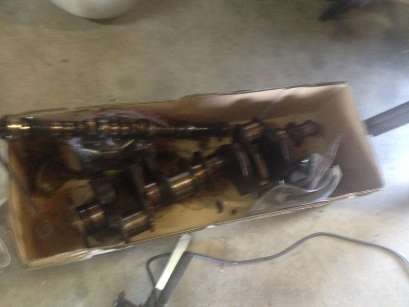

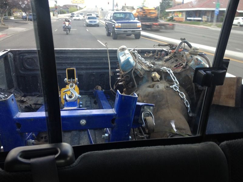

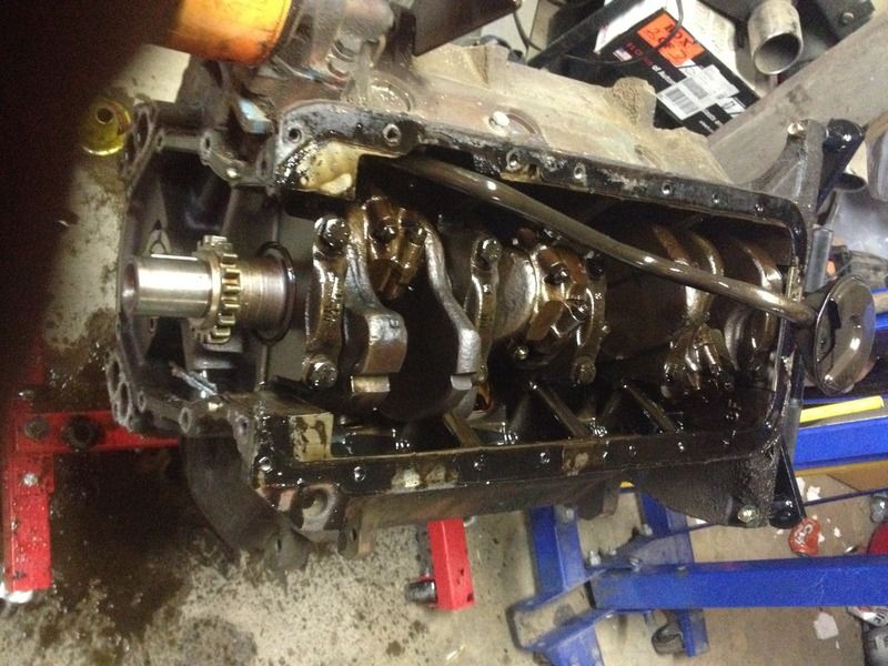

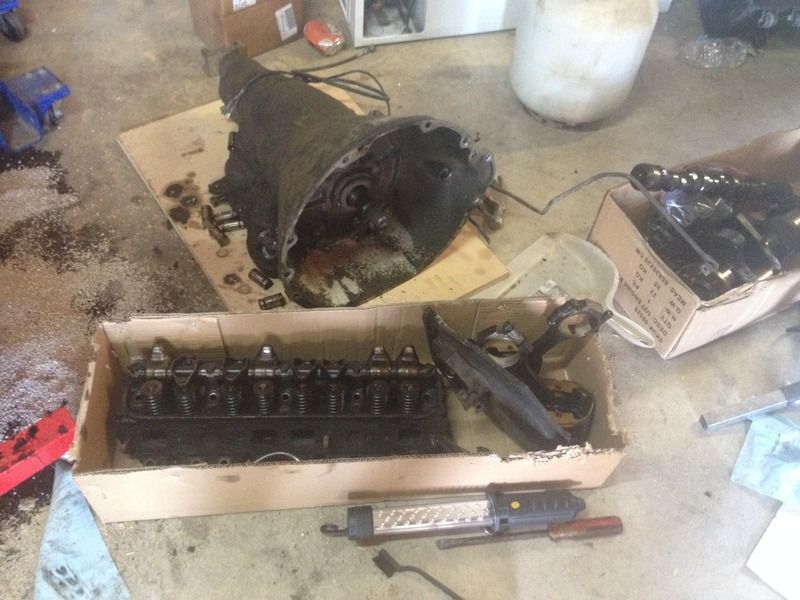

A buddy talked me into building a 440 and doing a swap. SO i found a used 440 and tranny in Reno and we took a road trip to get it.

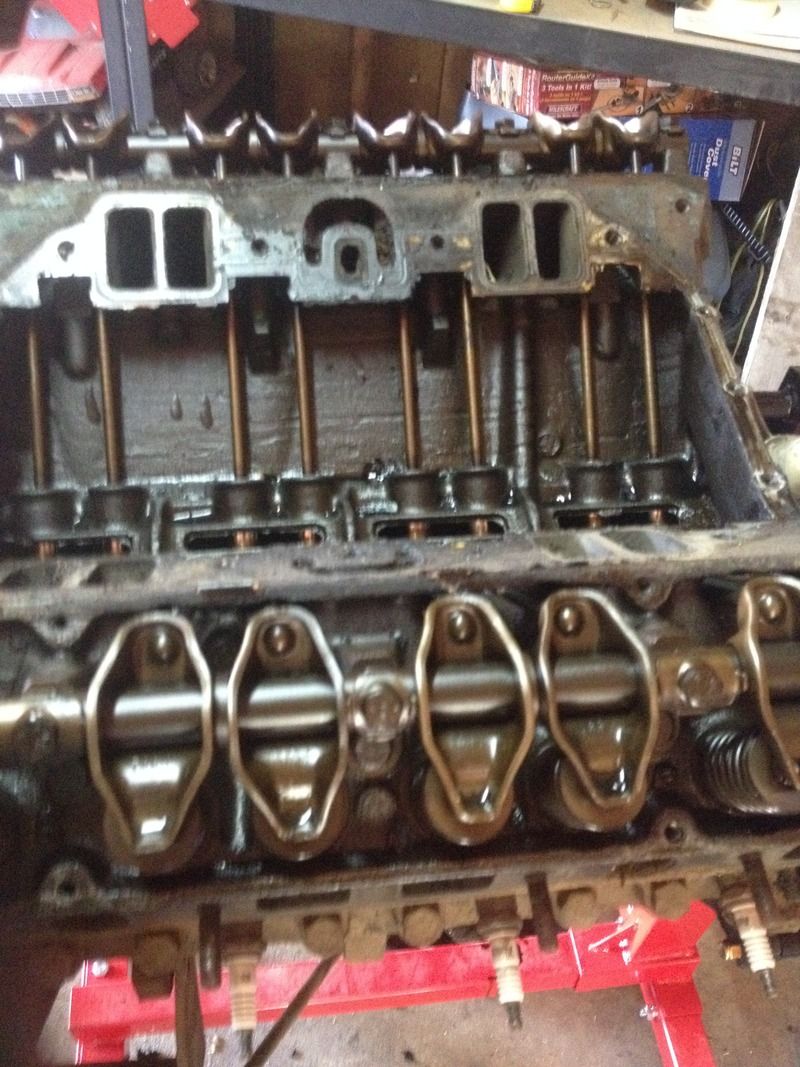

As soon as we got it home we tore it down.
Everything appeared to be in good condition.
Sent the block to the shop and had them check everything over and prep it, bore it and paint it.
So the new plan.. Spent some money at the 440 source and got the 440-528 stroker kit.
I also ordered the 440 source stealth heads, pro billet distributor, and an Eldelbrock performer intake
I still have a LOT to do. I have been doing as much research as I can before ordering parts. Each part has a lot of research since I have never built a motor before.

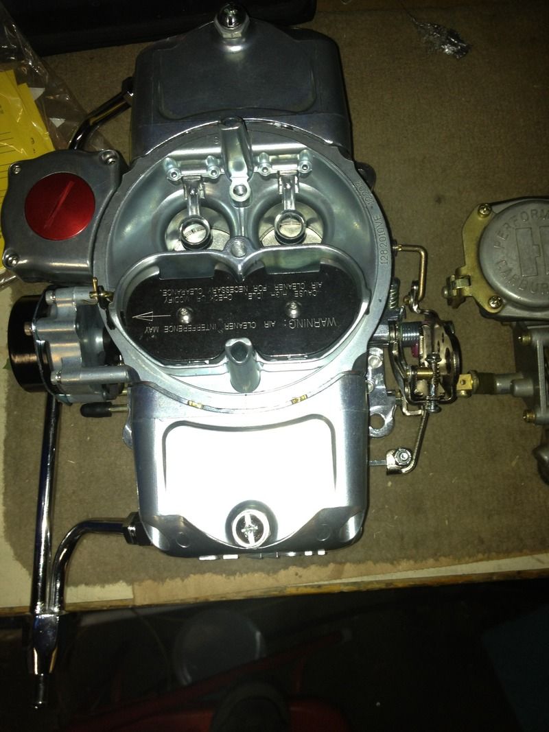

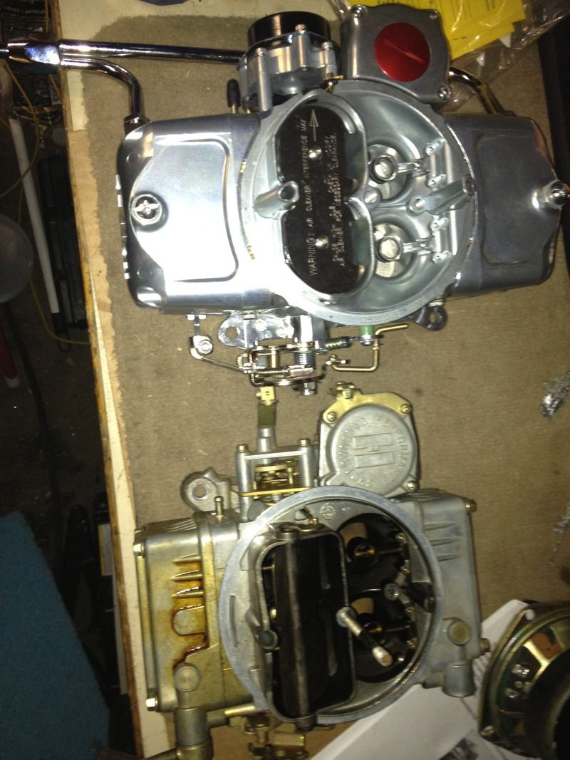

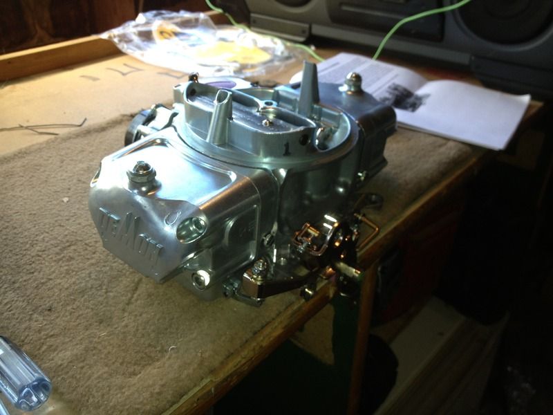

so finally ordered the Carb. Its a Holley HP modified by AED performance 1000 CFM.
SO I had to place everything together to get an idea of how it will look.
Very excited. Cant wait. Few more parts to order.
