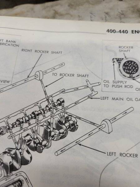

If the cam bearing with three holes is tight and spins, won't it cut off signal to the guage pressure as well as the rocker train?

pull the valve covers off , pull the oil pump shaft and spin the oil pump with a drill, see if it's actually moving anything up top ? the cam bearing could have spun.
No
Will just cut the oil to rocker shafts. Gauge will work.
