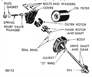

Relief valve could be hung open or a dozen other possible problems... A lifter out of it's bore, oil pump found a way to suck air, oil pump drive shaft sheared...
In your post you say "Intermediate shaft, no issue, gears just like brand new." did you actually pull the shaft & inspect it? Or looked & saw the gears look good? Cause twice I've seen the drive hex get sheared off...
Have you tried spinning the oil pump with a priming tool?
I did pull the shaft and inspect it, it's in perfect condition. I stuck the priming shaft down there and spun it....nothing. Priming before break in I had to hold the drill with 2 hands and it still tried to twist my wrists.

To check the pump p/up, remove the pump. Blow compressed air into the p/up passage in the block. If you hear air hissing, p/up has broken. If you here gurgling [ oil ], it indicates p/up is ok.
I like this test idea. Thanks!

why take the pump off ? just take the spring out and put a pencil like magnet in there and free and take the relieve valve out, clean and check for burrs. now you either found the problem or eliminate one problem it could be.

That what I'm gonna do!

a few ounces of oil will come out and maybe any debris so put a pan underneath. then after together i would prime the pump again and you will know for sure if there is resistance with the drill.

I saw a video on YouTube that disassembled a brand new hv oil pump. Only to find dirt and metal bits from the manufacturing process. So I guess I'm taking mine back off to check for foreign objects.

I had the very same problem, it was my pickup tube was to short. It had a straight tube and it was incorrect. 440 source sells the correct tube

This, and deburr the pump cover and rotors. They are really rough in that area. The relief valve should fall in and out on its own, some need a little polish work.
