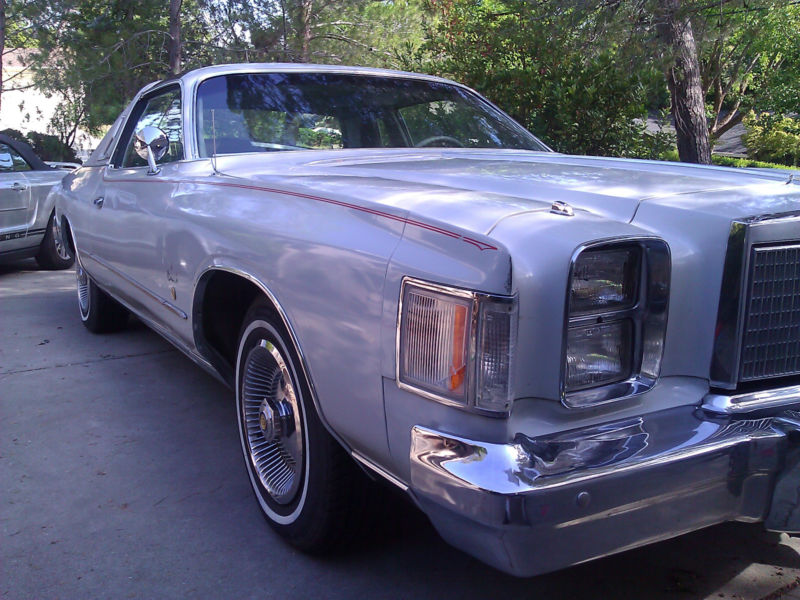

Well, I would start with that left front fender....

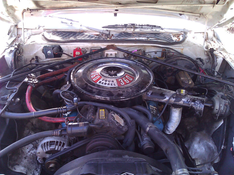

How about a picture under the hood? Are all the A/C parts present? Is it not working because the freon is gone, or the belt is missing, the magnetic clutch won't engage... Let us know a bit more about the actual problem and we'll try to help out.

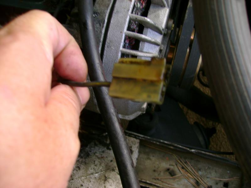

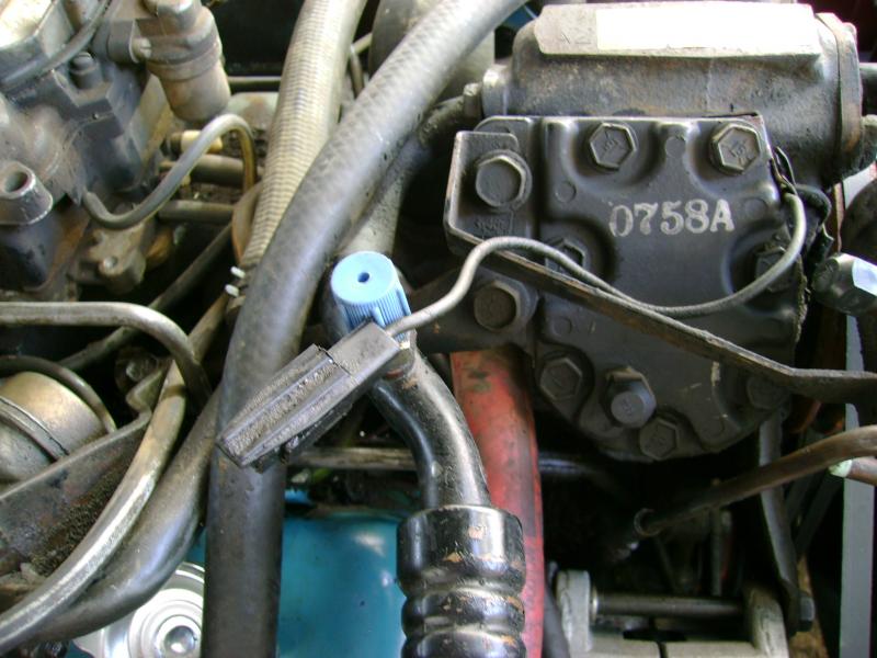

I rather worry about the a/c first than the fender....All components are intact..except these two wire one on the compressor and a loose wire at the alternator see pic's....the compressor is getting no power, hoses and all else look to be ok

You've got a few things you have to get figured out first. To begin with, you need to make sure the compressor isn't seized. Loosen the belts a little and put a ratchet on the center bolt. It should have some resistance but still turn. If so, good!
Next, the wire in the top picture is the compressor clutch wire. Without that hooked up the clutch will never engage under the pulley to run the compressor. It is connected in series to the low pressure cut off switch at the receiver/drier canister above the right front fender. If you can't find a matching connector, it probably got cut off. Try tracing the wiring harness to see if you can find the point where it was cut. Otherwise, you'll have to run a new wire and splice it into one side of the switch. The other wire on the switch connects directly to the push button switches on the dash.
When you've got all that wired up you can try to see if the compressor will run. With the engine running, try pushing one of the a/c buttons to see if the compressor kicks in. Most likely it won't. In fact, it would be very surprising if it did work. Chances are the refrigerant is low or gone from the system. An a/c system that old is bound to have leaks, probably several, and will require repairs. Without refrigerant, there is no pressure and the switch at the canister will stay off. Also, the oil for the compressor is carried by the refigerant and without it the compressor will seize in no time. The switch really is there to protect the compressor.
Try jumping the low pressure cut off switch. Pull off the rubber boot with the two wires in it and stick a jumper wire between the connectors. If the compressor starts running, you know you got the wiring right, so the pressure must be low in the system. Warning: only run the compressor for a few seconds at a time...it doesn't have oil going to it, remember!
If it still won't run, re-check the wiring. You can try to run a jumper wire from the connector at the compressor that is in your top picture to the positve side of the battery. If it runs, you have a problem in the rest of the wiring. Remember, only run it a few seconds at a time! But, if it still won't run, you've got a bad clutch coil and it will have to be replaced.

Also if going by the pictures it has been coverted to R-134.
Looks like that blue cap is a 134 fitting somebody put on. Bad news is that it looks like it is still the old receiver/drier can on there and the 134 will turn those pellets inside to mush and carry it around the system. Also, they probably didn't change the oil and 134 won't pick up the old R12 oil and deliver it to the compressor.
It looks like at a minimum you will need to flush the system to get out as much old oil and gunk and put in new. You might also take off the oil pan on the compressor to clean that out too.
