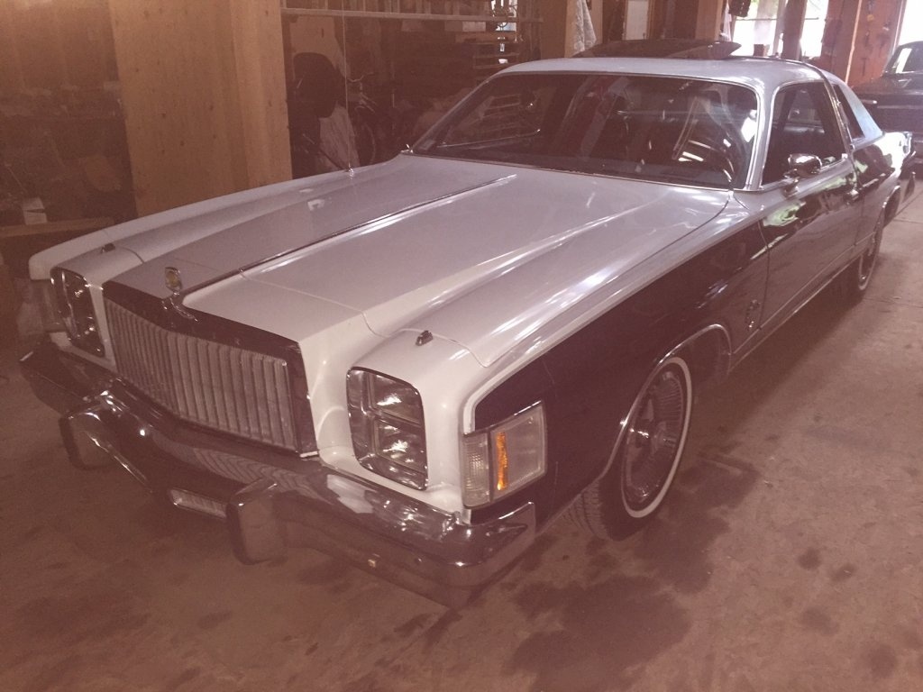

Any tips or leads as I wrestle with 38+ year old upper ball joint and lower ball joints. Using Moog. This Busted Knuckler is always open to learning trade secrets. Threaded uppers, pressed lowers. Thanks for any tips to come. Here is my '79 Cordoba except is it has the "package" of a '300' from the factory. 35xxx miles.
Nice, mine was beige and brown with beige interior/buckets.
