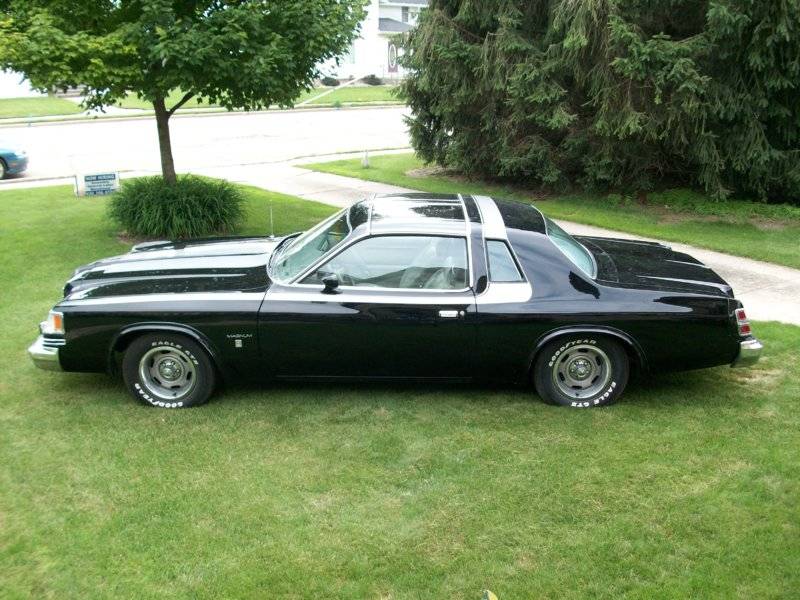

Its nice to dream but sometime reality needs to set in. Some of the parts you list are difficult at best to find. It took me 35 years to find another '79 Magnum GT that had the addition of E58 package and T-tops. Some could care less but it nice to bring one of my cars to a car show and not see another like it.

I have a 79 Magnum GT myself. I have my eye on a regular Magnum XE to apply my ideas to.
