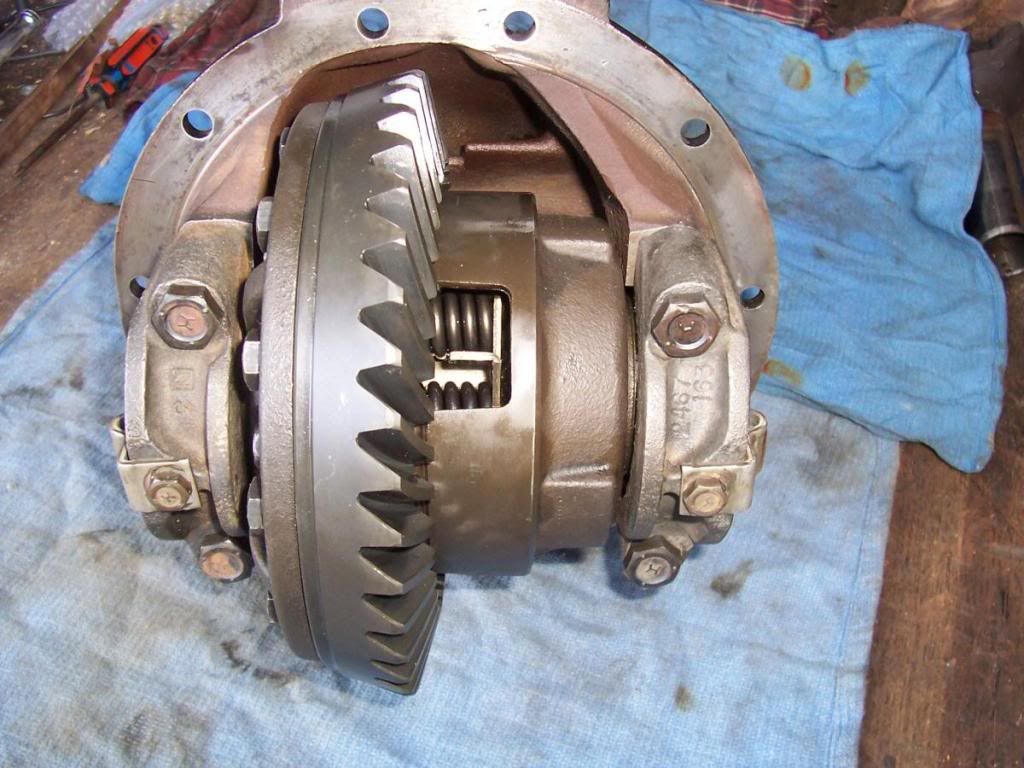

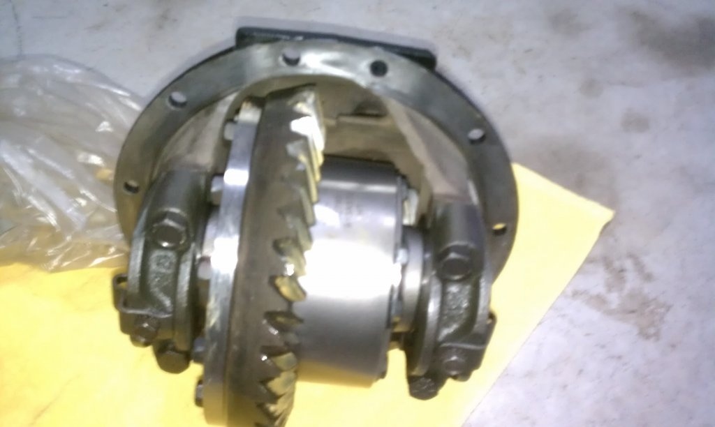

Don't know of anyone up your way but what SG do you have? The Borg Warner or the Spicer Power Lock?
This is the Borg Warner cone type....
And this is the Power Lock....one is for a Dana 60 and the other is for the 8 3/4. Do ya know which one is which? :D And the PL doesn't have springs in it.
i have the borg warner type with springs.looking online they are about $1300 complete ready to bolt in. how much to rebuild one ?
Depends on what all is wrong with it. They are not that hard to take apart for inspection but I do like to unbolt things evenly since there's spring pressure on the two halves. If you are interested, I can send you pics of what it looks like inside....
