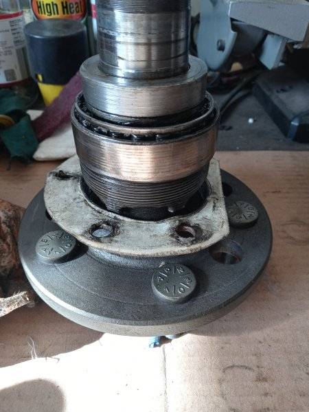

Referring to post #17 [ Thanks, Bob ]. These green brgs are the same type as GM used back in the 60s on Buick-Olds-Pontiac. They stopped using them because they were [a] dangerous & failed quickly.
The problem is that the grease dries out from the heat & then the brg fails. The inner race will spin on the axle & the axle walks itself out...Ruins the axle as well.
My GTO came with these brgs. What I did: there is a space between the brg & the inner seal. I drill into the axle housing between this space & fit a grease fitting; inner seal is removed from the brg. I pump some grease in when greasing ball joints etc, so brg gets fresh grease.

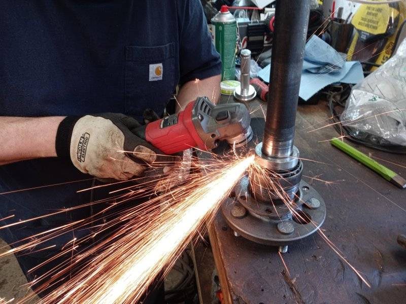

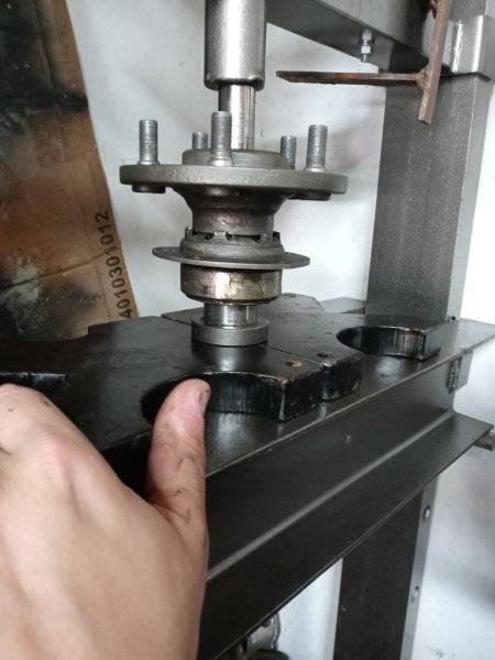

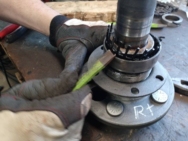

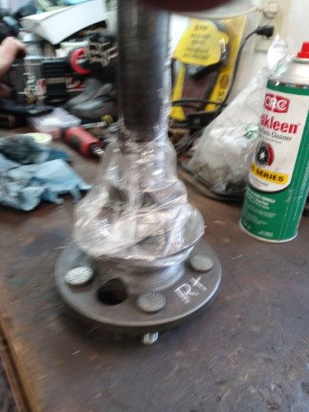

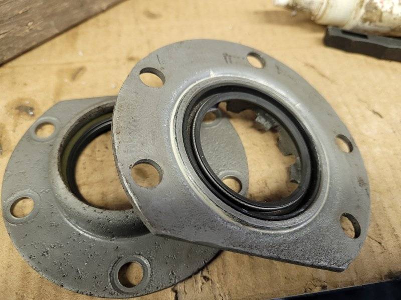

View attachment 1450566View attachment 1450567View attachment 1450569View attachment 1450570View attachment 1450571View attachment 1450572
Looks familiar, got this done yesterday, with the help of my Son !!!
New Timkins ready to go back in !!!

C-clip axles are totally different, used on Chevs [ not B-O-P ]. The inner race runs directly on the axle. About 1970, B-O-P upgraded this poor design to a tapered roller brg. Sound familiar?

Early spring inspection on my Challenger, turned up a few needs for repair. One is the right rear axle seal. Looks like the bearing needs to come off, to replace the outer seal, so I'm considering going to the "green" bearings, and eliminate the adjustment set. Anyone been running these, and Pros or Cons ? We put these in my Son's Duster, years ago, but the car hasn't seen much usage. Looking for some feedback, Thanks...View attachment 1450537
